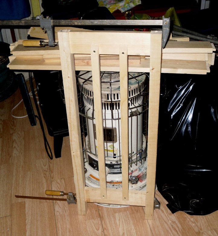

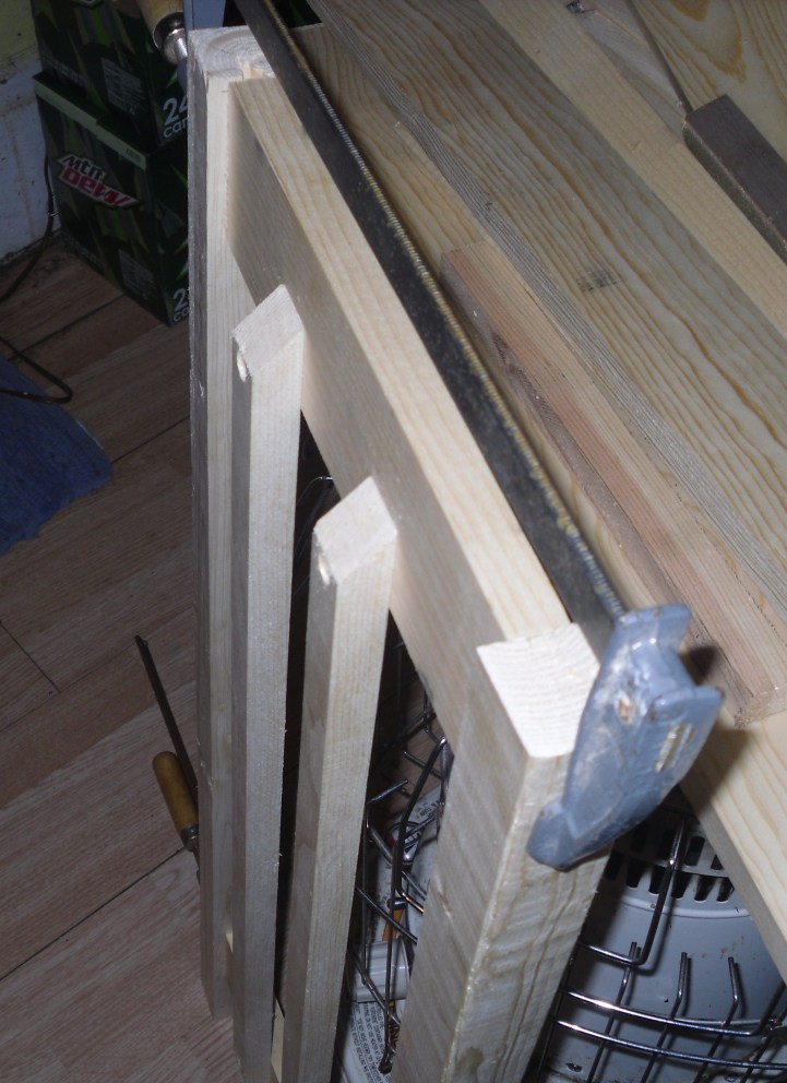

Ok, after fighting this thing for about 3 hours, I've got most of the pieces milled up.    Tablesaw needed aligned, again.   Mortise chisel needed sharpened.   Anyhoo, I brought most of the parts back to the house for some glue-ups.   Just the two ends right now.   Once they've set up, I'll add the front and back aprons.  No fancy curves this time, just a simple table for the kitchen.   Oh, pictures, right?ning-226-49728-96.jpg?width=721Just an end, and a deyail shotning-227-49728-1.jpg?width=721Simple spindles
 parts list:   3-1x4x8' @ $1.88,   1-2x4x8' @ $1.98,  one top panel, 16"x32"@ $7.99, one bottom panel, 1x12x36"@ $5.99,  one small pack of 1" nails@ $.99, and one small pack of 1" drywall screws@ $1.98.     So far, three hours of shop time.   A new Irwin combo square was also bought for the shop.   Legs are 34" long, by 1-3/8" square.    The 1x4s were ripped down to a full 3" width.      Spindles were ripped down to 1' wide.  A 45 degree bevel was added to each end of the spindle.
Not included in this list:  several bandaids.     Seems I cut a knuckle wide open, cranking the tablesaw's bevel back to 90 degrees.    Off to a rough start.

Only thing I can add is when you cut a 2x4 make sure you cut both sides to square it off so the rounded corners don't show.
Or did you mean for them to be like that?

The project is coming along fine, I love your glue up bench, a kerosene heater. Now that's ingenuity.
All exposed corners will be rounded over to match.   Spindles are made like that because I got tired of chopping mortises by hand.   That 32 oz ball pean I use as a mallet gets heavy after an hour's work.

Same old camera, just the right settings is all.   The "glue-up bench was the kitchen counter top, right over the sink, in fact.   I left one clamp out in the shop, so I'll have to motor out there to get it, the top, and the bottom shelf.   I still have to notch the bottom shelf to go around them legs.   Means bringing in the sabersaw too, I guess.   Table is supposed to be done in time for Valentine's Day.
New way to get dry lumber for the project???
