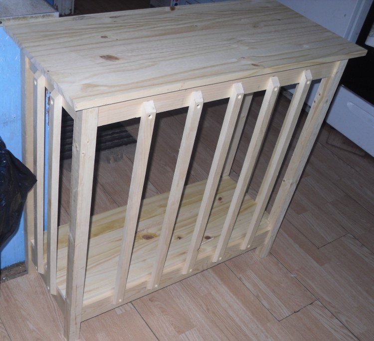

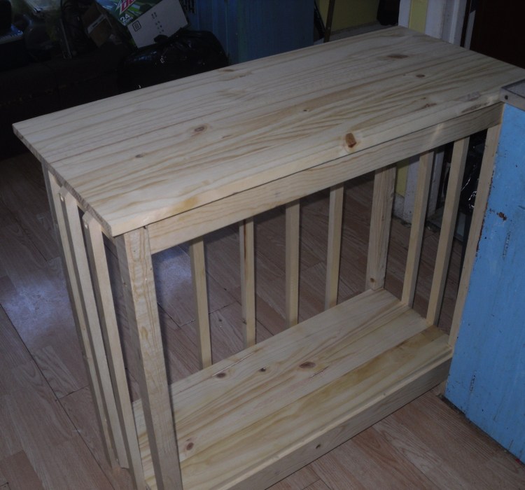

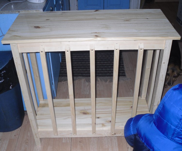

 and.....some pictures too!   Table is assembled, now it's the Boss's turn with the contact paper, and the paint brush.    I'm NOT doing a table in fancy woods, only to see paint and paper cover it up.   Anyway, here goes with the picturesning-islandtable001-49582-8.jpg?width=75That blue Blob is just the grand-Brat going by, camera hog!  This is the back view of the table.ning-islandtable002-49582-18.jpg?width=7Front view ( no grand-brat) that "step" will be covered with molding.ning-islandtable004-49582-73.jpg?width=7Another view of the back.   Not bad for $28 worth of pine and screws?   Top and the bottom shelf are glued up panels from Menards, saved a bit of time.    Too bleeding cold to do any glue-ups in the shop right now.     Still needs a good overall sanding ( to get ready for the paint) and that molding in front.    It even sit level on the floor!
  Top is 36" long, by 16" wide.    Legs are 34" tall.    Spindles are 3/4" thick, by 1" wide.    A 45 degree bevel at each end of the spindle.   Bottom shelf WAS 36" long, until I cut it to fit in the base.    Shelf is 12" wide.   Aprons are 3/4" by 3' wide.   I tried to space the spindles out to get the most out of just a few pieces.   Now, someday, maybe one out of Oak?    Or, maybe just the top in Oak, and the rest in painted Poplar?
