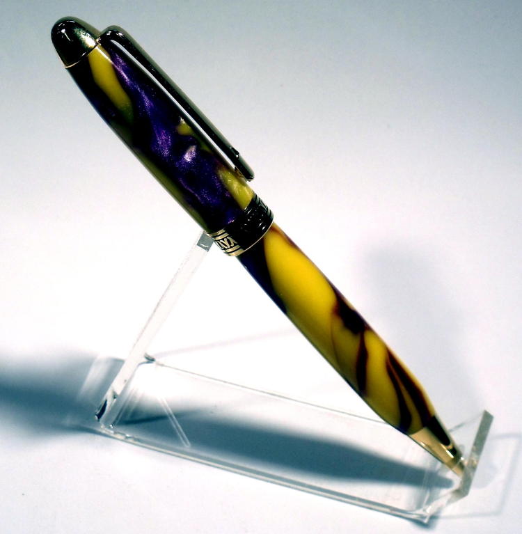

February 17, 201115 yr comment_49407 Hopefully this pen will open some doors for me. I was asked to turn some pens for the local college bookstore. I couldn't match the colors with a commercial blank so a member over at IAP cast some custom colors for me. Here is the result. Custom blank on a TI gold euro, sanded to 600 grit followed to 12,000 MM, a white diamond buff and Ren wax. This is a slim line turned in Rus Fairfield's "Fat Line" style. The wood is cedar. The plating is gunmetal. The finish is CA/BLO William Young style. This pen is entered in the IAP Russ Fairfield challenge. Report
February 17, 201115 yr comment_49410 Those are two very nice pens Greg. I like the custom colors. How it works out and you get lots of orders for that one. Best of luck with the other also. That cedar looks very fine. I have turned a few cedar ones and some of them turned out pretty good and a couple of them were so soft it would chip our some. That one looks awesome. Best of luck on it. Report
April 2, 201115 yr comment_49409 Whoa!!! Character! On the wood one, tons of character, great job Greg! The composite one is nice too, but man I sure do love those wood pens, specially that one. Report
April 2, 201115 yr Author comment_49408 Thanks for the kudos John, Robert, and Joshua. Robert I use Woodturningz often. The guy that makes my blanks does it from home and researches colors for me. I like the idea of the year bands for the euros. I may have to give that a try. The ones I have made so far are for sale in the college book store. I may have to go to a higher end kit. I have been told I am selling to low. Report
