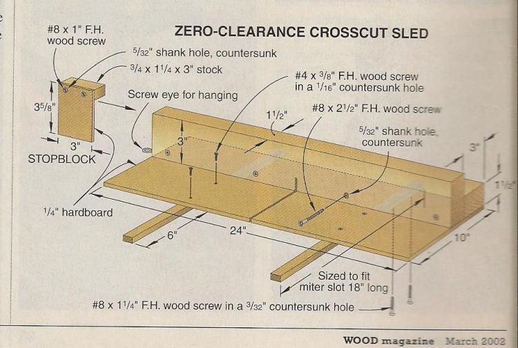

Good Morning Friends,
Here following is a table saw sled you might wish to make for your saw and have very accurate cuts every time.
ning-tablesawsled-49120-22.jpg?width=750
This could be a very valuable tool or jig when accuracy counts.
Very nice jig Ralph, Thanks for sharing and providing such a nice drawing.
Ralph...........the only change.......or additiion to your jig that I would suggest would be to laminate 4 or 5 pcs of 1/4" stock for the backbone of the jig. That way you are assured that it will not warp in time and the jig table would stay flat. And maybe even attach a block on top just over the saw kerf to have the added assurance that your fingers are far enough away from that spin'n blade.
That's what I did with my cross cut sled, and its still dead flat after 10 or more yrs.

I have to admit that it is not my jig but, one I borrowed out of the WOOD Magazine. However that is not to say I won't build one to go along with my 45º sled.
I may have to make this one now that I have my new T/S. This drawing makes it look simple to make.
Thanks
