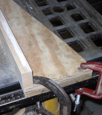

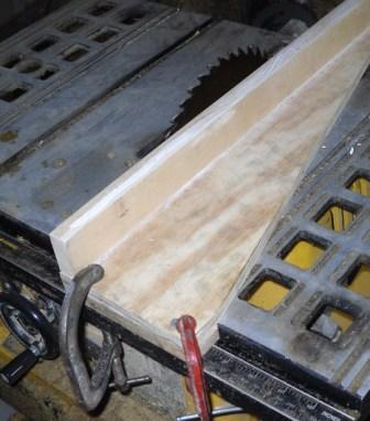

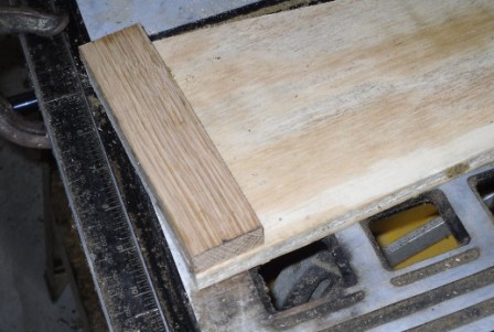

A few pieces of scrap, a few screws, and a couple of "C" clamps, and the saw was back in business.   I used a piece of plywood, with a "factory" corner, and edge.    A hardwood cleat was made to ride on the rail for the old fence.   I lined up the factory edge with a miter slot, and clamped the cleat in place.  A couple screws held it it place.   Next, a piece of 1x went along the factory edge.    1x was just a 1x2.   I screwed it from the bottom of the plywood, using the edge of the plywood as a guide.   A few pictures?ning-010-49050-52.jpg
cleat, and plywoodning-011copy-49050-11.jpgclamped in place on the sawning-012copy-49050-76.jpganother view.    This fence can also be used as a "speed-square" for a circ.saw,  or as a guide for routing dados with a router.   IF one takes the time to square things up when building this "jig", better results happen.    Fence can be made taller (as needed) by changing out the 1x extension.   Be sure to brace a taller fence, with corne blocks.

I don't know why I didn't think of the lip on the edge to square it up!40.gif
