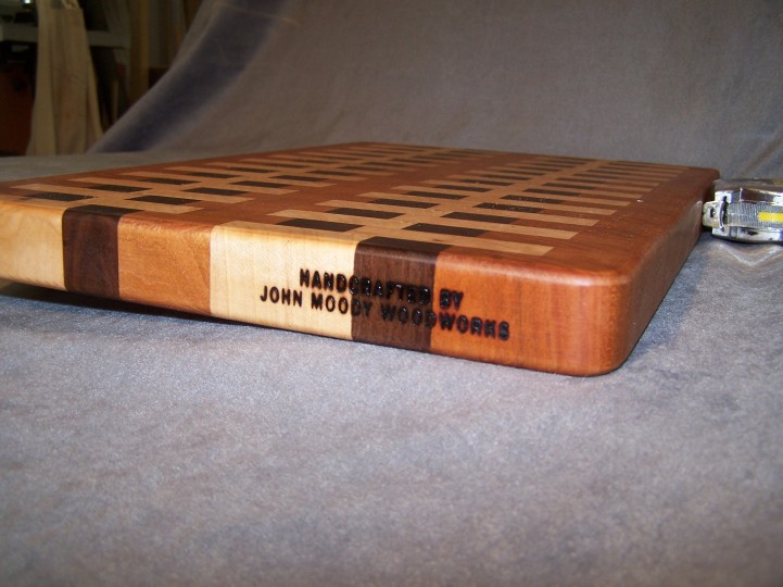

Here are a couple of pictures of what I am putting on my cutting boards. I am putting it on one end.
This was the first one and it got a little light near the end but it is acceptable to me.

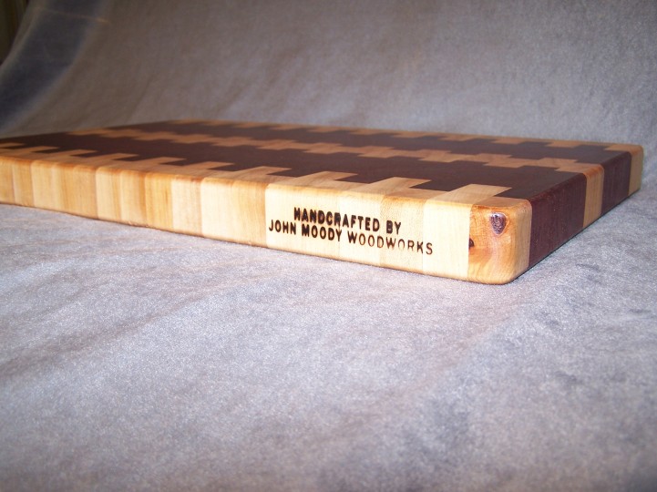

This was one of the others.

Thanks for all of the input you guys gave. I am going to like this brand.
Looks great john, suits it and looks right at home.
Looks great John! Very down home and warm, I like it.
