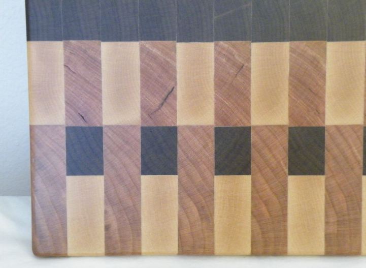

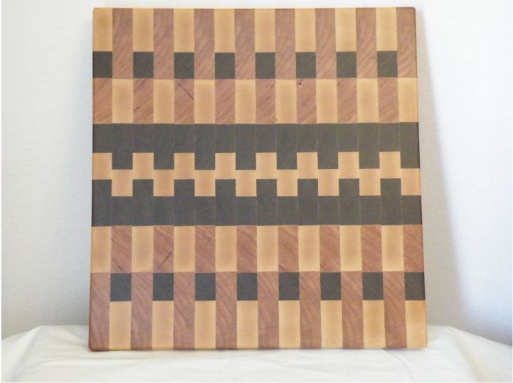

March 6, 201115 yr Author comment_48909 Ok.......here it is. I'm sorta happy with it. I'm not planning to sell or give it away. It is roughly 14-1/2x16x1-1/4. I used walnut, maple and cherry. The real part that I need to work on is hopefully visable in the close-up view. There is a strong 1/16"overlap when if there had been good planning, it would have been either a flush straight line or overlapped to help out in a design. I drowned this thing with about 4 heavy coats of mineral oil yesterday afternoon and then when I quit for the day...........I really laid it on. I can't believe it..............it's all soaked in. For some reason..........I can-not load directly. Maybe it's cuz I'm computer dumb. Anyway.......hopefully they are included and you just have to click to view  Report

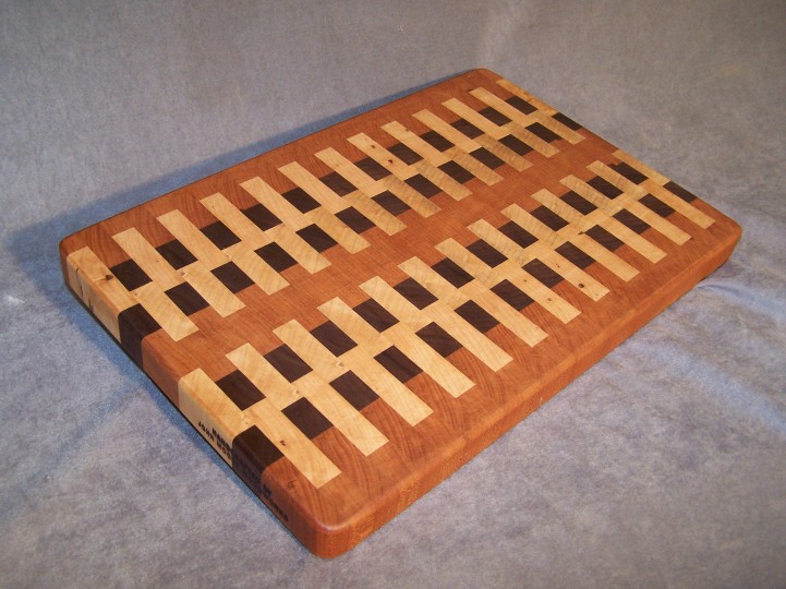

March 7, 201115 yr comment_48908 Gary that looks fine. You did a good job on it. Â Here is one that I finished last week for the Craft show on Friday. It is Cherry, Maple and Walnut also. Â Report
