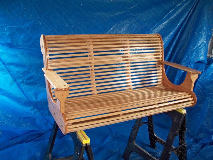

Well, one coat down and 2 to go.  The swing is going to be delivered to Alabama in a couple of weeks and I wanted to let the finish dry well.  I shot it with lacquer and even though I'm a kid of the 60's the fumes got a bit stiff even with an organic mask.

Now that is one helluva a nice bench Ron!!! Great job man. Looks comfy too.113.gif

Wow! Very very nice Ron. Is the swing going to live inside or outside.?

Rich, it is kinda going outside.  It will hang under a 20 X 20 screened in porch.  I have one one my shop porch and I "sparred" it but I wanted to try lacquer on this one just for grins and giggles.
Hey Rich, you have concerns whether the lacquer can hold up?

Thank you John.  This is the third one I've done and they're pretty labor intensive.  There are 44 of those slats that all have to be zipped through the planer and then I run the edges across my router table to take the edge off them.  The hardest part of the whole project is the finish because its hard to cover the slats that curl over the top and front.

 It reminded me of my first and only swing project. I bought the plans in Amish country and the drawing on the front looked great. I soon discovered that it was to be 8' wide and made of 3/4" Oak. Would have been massive and weighted a ton. I revised the plans to my own size and built it. Then discovered the chain hooking points were not properly placed and the swing could tip. Fixed that only to discover that the design wasn't strong enough and needed reinforced. I sure learned a big lesson with that project. LOOK CAREFULLY AT WHAT YOU BUY.
