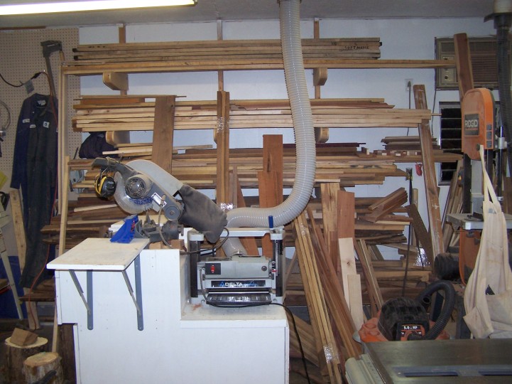

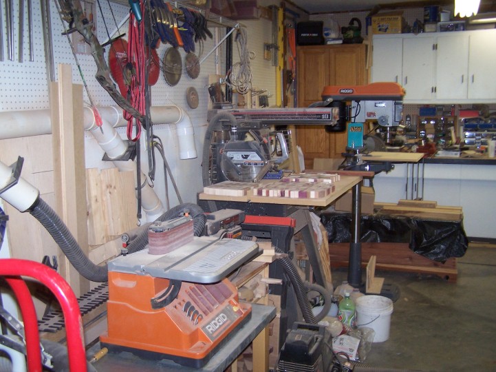

I have a run alone the wall here and then another one across the ceiling and then drop off to my tools.
ning-100-3796-48584-90.jpg?width=721
Here it drops down from the ceiling.
ning-100-3797-48584-54.jpg?width=721
