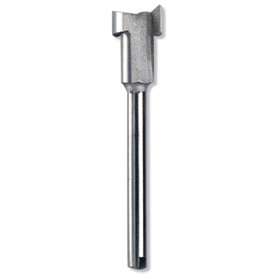

March 18, 201115 yr comment_48485 Well after banging my head all night I remembered this bit from Dremel http://www.dremel.com/en-us/Tools/Pages/ToolDetail.aspx?pid=198 It is what you want and with cutting the first groove the groove for the first part of the compartment this bit would give you a small groove in the edge for those channels you want. And it IS flat bottomed. Report
March 18, 201115 yr comment_48484 Or grind this one down     http://www.dremel.com/en-us/AttachmentsAndAccessories/Pages/AttachmentsDetail.aspx?pid=655 Report
