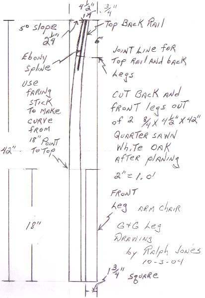

Here is one method used in the art of Arts and crafts pieces;
ning-ggarmchairlegdrawing-48359-25.jpgThis drawing is of a Greene and Greene chair legs with the front one being the back leg and the front leg also cut from the same piece of wood.

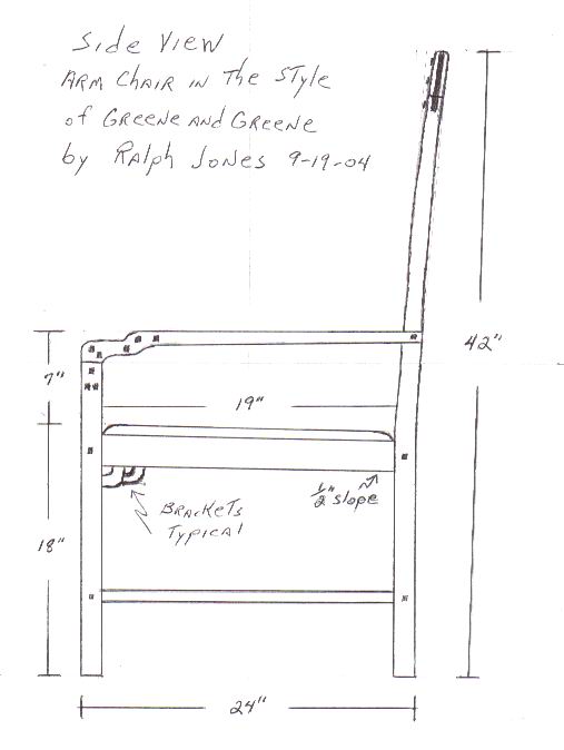

Next I will try to post the arm connection of the chair as well as the rails.
Note how the joints come together in this style of a chair by Greene and Greene, while in conventional chairs the parts may be connect with the use of dowels, mortise and tenons or in some cases even brad nailed with a little glue and the properties of the wood used would most likely be much different than A&C pieces.
ning-ggarmchairsideviewdrawing-48359-35.

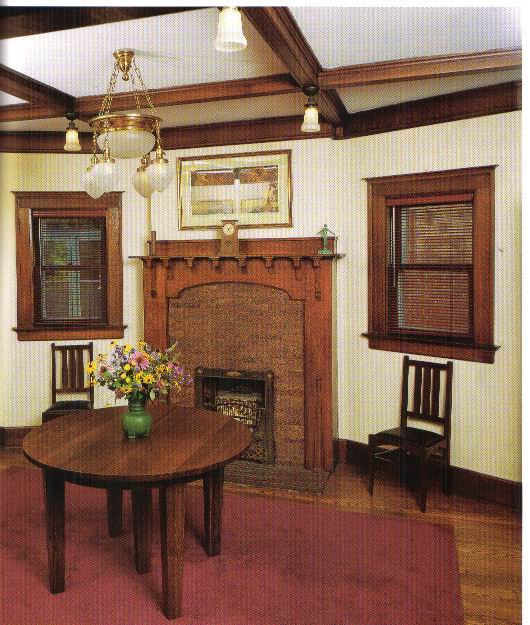

ning-anartsandcraftsdesignroom-48357-71.
This was the style of the homes and settings that started out to be just plain designs but they soon caught on and the news spred about the truecraftsmanship in the making of furniture and home decore that was eye appealing and worth the money to buy. So now you can see the difference of the way people lived in their humble homes. This style and pieces of furniture are well accepted today and the demand is astounding.

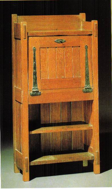

Following is one of Gustav Stickley's pieces;
ning-gustavstickleydropfrontdeskmodel518This is one of Gustav's drop front desk made in the late 19th century or the early 20th century.
The Arts and Crafts movemnet starting to decline after 1929 and things ran down hill after that period of our history.
Now I and several others are trying to bring back the art of constructing our furniture in the same fashion as those made by the masters.
I Like the art's and crafts movement. I like this desk thanks again Ralph

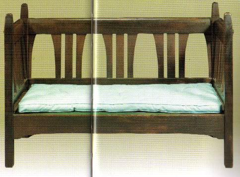

Don't get me wrong for Gustav Stickley also have some KD pieces such as the settee that he made and I'll see if I can find a picture of it for you to see.
ning-gustavoaksetteemodel165-48352-45.jpThis is not the one I had in mind but it also was one of his knock down styles settee's for he incorporated bed rail connections so the front rail could be knocked up out of the connectors and the entire back rest was also fixed with the connections to allow it to be taken down when one moved it from room to room or to another home as time went along.
I made this settee myself copied after Gustav but failed to take a picture of it however I did sign the back rail on the inside as well as to date when I made it.
I now have a branding iron (electric) that I use as well as to autograph and date the piece.
Pardon the crease for this picture was in the middle of the two pages it was printed on.
