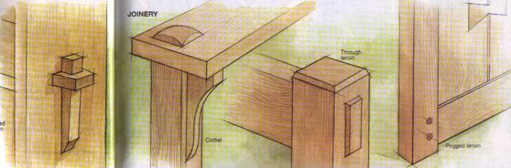

March 21, 201115 yr comment_48291 Good Morning Friends, The other post that I started was getting a little bit long so I am starting another post in regard to Arts and Crafts furniture compared to conventional store bought furniture. Â I was pleasingly surprised that I received a furniture request from Sydney Australia for three book cases in the Arts and Crafts style and it appears that I might get the commission. Â Now for two differences in connecting joints in conventional furniture vs Arts and Crafts pieces. Conventional furniture joints may be made with the use of dowels, pocket hole joinery while A&C pieces may have trough tenons and pegged so the joint will remain intact over the years, with or without glue. Here following is a sample of a through tenon; Â This method is not a hard joint to make and will out last a conventional joint for years to come. Note the peg that will allow the joint to remain solid for many years and is strong enough to withstand hard use over the years. Â Report

March 30, 201115 yr comment_48299 On those pegged joints, do you "draw-bore" them for a tighter fit?    As for my little shop, I hand chop the mortises, and saw the tenons with the table saw, using a series of nibble cuts.   I don't have a proper vise to handsaw the tenons, so the old Frankensaw gets the work. Report
March 30, 201115 yr Author comment_48297 Hi Steve,I don't recall the term draw boring, how about a little tutorial so all can benefit. Report
March 30, 201115 yr comment_48296 It's been in.  Put a little story in today. Basically, one uses an off-set hole in the tenon to "draw" the joint tight.  Ralph Allen Jones said: Hi Steve, I don't recall the term draw boring, how about a little tutorial so all can benefit. Report
March 30, 201115 yr Author comment_48295 Steve, Now I understand what you are talking about and this is not called a peg as through peg but instead a wedge piece that is used to draw the sperader tight against the leg or rail on the bottom of the rail reaching from leg to leg. As seen in the following picture; Â Report
