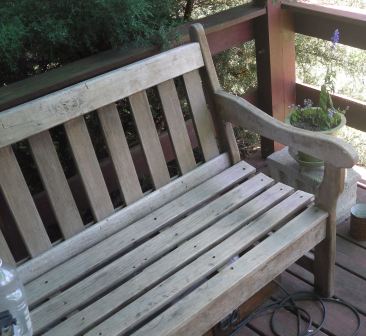

March 31, 201115 yr Author comment_47970  On this bench, all M&T joints have been pegged.  I used some tongues that I ripped off from the T7G boards in the seat.  I sharpened on end of the homemade pegs, drilled a hole through the joints.   I drove the pins home, and sanded off the excess.   When done, the pegs looked square in section.    A "Square peg in a round hole" sort of thing.    I used the draw-bore trick to make the joint tight.  Bench in this picture has been sitting out on a back porch for over three years now, joints still nice and tight. Report
