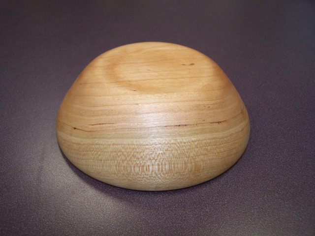

April 5, 201115 yr comment_47659 Ron, Here is a video on turning a maple bowl with the EWT Finisher. I have one of these and it will cut so smooth you hardly have to sand. This is a finishing tool.    Now you can purchase your own cutters and make your own. Fastenal sells the key stock in three foot lengths. You can order the cutters from this site, http://globaltooling.bizhosting.com/products/carbide-insert-knives.html  and you can order the round ones from here. http://www.carbidedepot.com/wood-turning.htm  You can build one of these and turn your own handle for about a third of the cost of the commercial one. I haven't made one my self yet, but I do have some cutters on order. I did purchase the one in the video.  This might get it clean enough to not have to sand any. I post a cherry bowl right after I took it off the lathe with no sanding on it at all.  That bowl as not sanded and those pictures were right after I took it off the lathe.   Report
