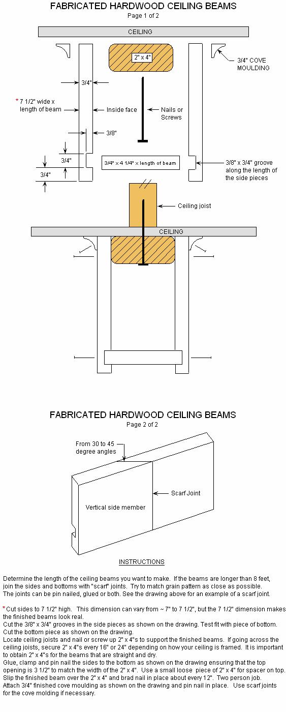

April 7, 201115 yr comment_47554 John has agreed to allow me to post some of my older designs here on his new Forum.  Here's a Canvas CAD program design you might like to start out with. It's one I designed many years ago when I wanted to build false ceiling beams in an older house we used to live in.  The design uses stock lumber sizes. I made ours from red oak with a Minwax Provincial stain and a Satin Poly finish. You will need a good stacked dado set, a good table saw and blade and steady hands. Simple, and looks very nice when complete.  Lots more to come..  Larry  Report
April 7, 201115 yr comment_47563 It is so amazing that you actually chose this one to post first Larry, I have been wanting to install an ornamental box beam through my home for years, great stuff man, thanks for kicking us off with a great detail of how to do a fabricated beam! Report

April 7, 201115 yr comment_47561 This is great. Thanks Larry. I have always wanted beams, in a ranch house. Just me, I know. bob Report
April 7, 201115 yr comment_47560 For those who want to make this beam(s).. You will note that the design gives you a "prportional" beam, meaning the the height to width ratio is just right. And because they are higher than the cheap ones, they look real. Some beams are flatter, and look funny. My opine.. LarryBob Kloes said: This is great. Thanks Larry. I have always wanted beams, in a ranch house. Just me, I know. bob Report
