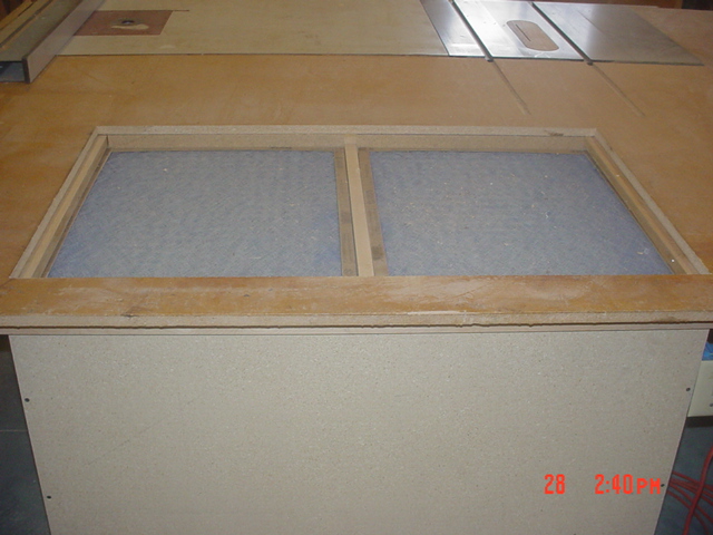

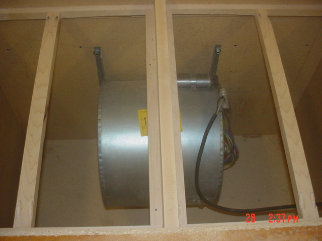

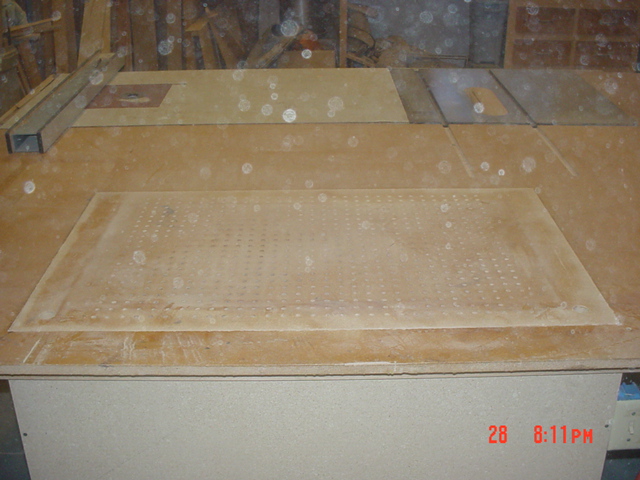

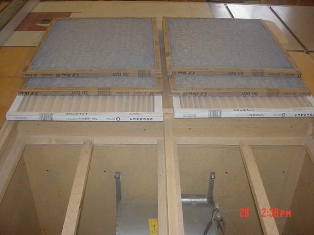

Bob.........I know your asking for a suggestion for a new vac, but have you considered a down draft table???? There is a hummm to the squirrel cage fan, but it is more tollerable to me than the squeele of a shop vac.........and one hockey sticks of a lot less expensive.
Mine is a particle board box with the fan mounted to exhaust to the outside of the box, with 2 sets of 3 stacked furnace filter. The top 2 filters are 8 merv and the lower filter is either a 12 or 13 merv rating.  The fileters are 16"X20". Then above them is the perferated sanding grid. Not only does it suck down the sanding dust.............it cleans my shop air beautifully. Oh ya....it is also my tablesaw outfeed table.ning-downdrafttableview-47236-35.jpg
ning-downdrafttablefilters-47236-73.jpgI'm including some photos.ning-downdraftfiltersinplace-47236-1.jpg
