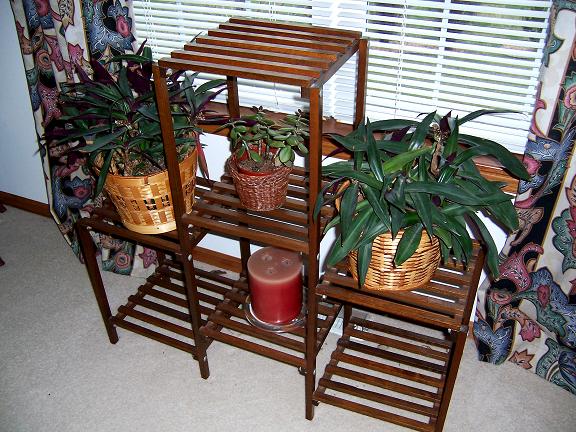

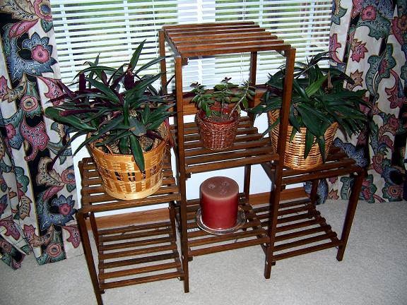

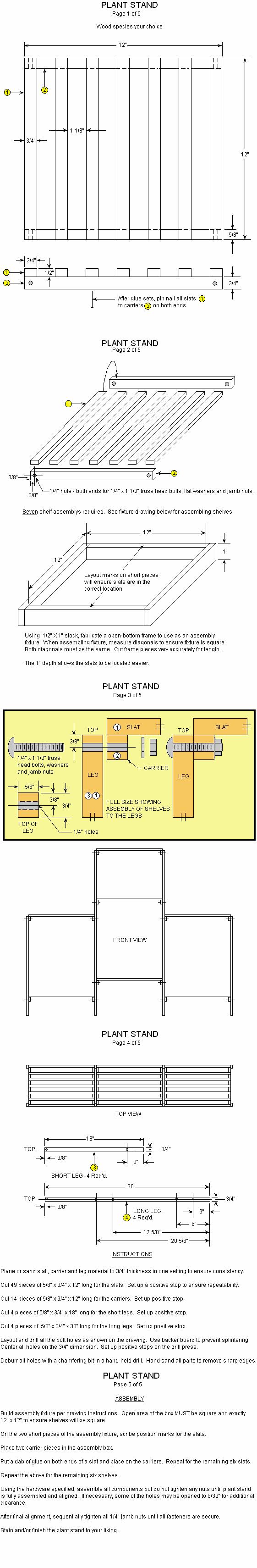

This Plant Stand in unusual in that it has many staggered "shelves" made from basically one size of slat.  Because many slats are required, setting up cutting jigs for size and length make the task of preparing the parts pretty simple.
I also made a specer jig to ensure the slts were in perfect locations during the building of each shelf.   The slats ware glued and pin nailed to the frame pieces.
Here's two images of the Plant Stand.  The plans follow the images.
HIt the wrong button.  Here's the plans..

My thoughts are pretty simple. I can learn from looking and seeing. When I see something new I study it for a while then hit the shop and play. Many times I go back to a drawing or plan to see where I go wrong at. I do my plans with a ruler and pencil etc. Looking at these plans you provided the first thought I had on the engineering end of things was how did you join the shelves. Your plans showed this quite clearly. In my opinion you have a gift and some people just need to see to learn. Then go play with it and finish the learning process. I am looking forward to your blog, if it is as precise as your drawings then it should be great reading and learning.

Keep the stock sizes the same, but down size all other dimesions by 25% and see how that looks. It will reduce the number of slats and their lengths as an example.   Nuts and bolts remain the same.  Proportionately, it should look all right.
