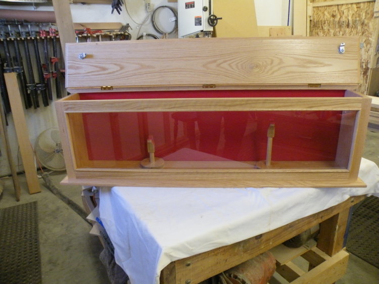

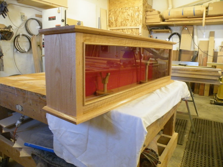

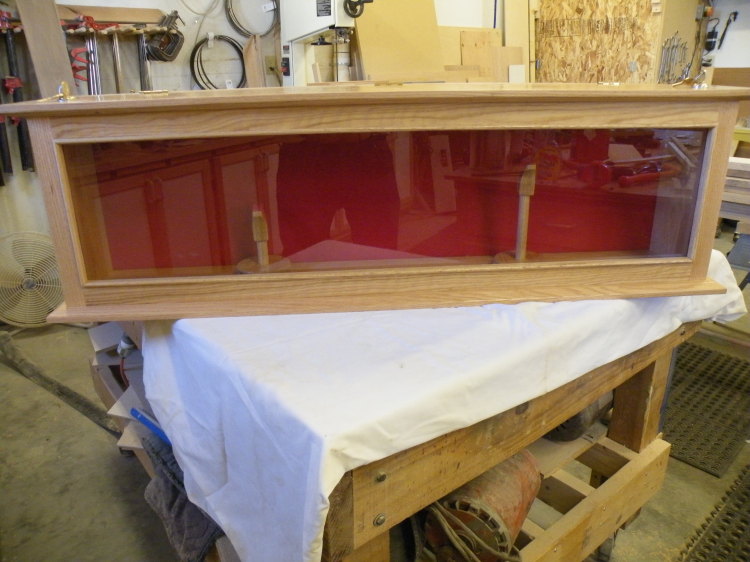

April 24, 201115 yr comment_46520 I was asked to build this display case to be given to the clients daughter. He wanted and got a red velvet backer and he also wanted it to open from the top........with a lock. I had planned for 1 lock, but either I didn't see the bow when milling and cutting.......or it bowed after cutting. There was maybe a 1/16" gap in one corner and it looked terrible. Anyway, I had to go with locks in both corners, and problem solved. The glass is held in place by that rubber stuff that fits in a kerf. No stain..........just clear lacquer. Plus the back has a french cleat to hanging on the wall. I also made the little cradles to display the rifle. Thanks for look'n. Report

April 24, 201115 yr Author comment_46525 Thanks guys.This is....I think...... the 3rd time I've used bead moulding.........and it's easier than I thought. I hated using 2 locks....but didn't want to make a whole new top............and mortise in those hinges again. Report

April 25, 201115 yr Author comment_46523 Ya, I had the client bring his rifle over and we even went so far as to lay a level on the barrel, and I trimmed qn 1/8" at a time till we got it. Them cradles????? I had no idea what I wanted except they had to have a fork. I just drew out a pattern, layed it on a piece of 5/4, and went to the scroll saw. They looked bulky, so I tapered them from bottom to top. I think they now looked respectable.............like I know what I'm doing!!!!! Report
