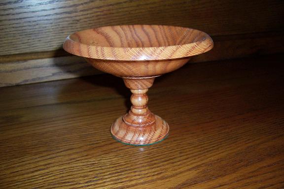

April 27, 201115 yr comment_46429 Some years ago, WOOD published plans for a beautifully proportioned 8" Compote.  I don't have an 8" Wood Lathe.  I have a 6" Metal Lathe.  No wood turning tools, just a square turret with some turning bits in it.  So here's what I did.  Resized all the dimensions on the plan down to 75%. Made it in three pieces with locationg dowels Using the carriage wheel in one hand and the cross-slide wheel in the other and using hand/eye coordination, I shaped all three pieces. Assembled, stained and finished it on the metal lathe. Oh what fun that was..  Here's the image of it after completion. Larry    Report

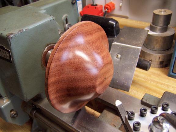

April 28, 201115 yr comment_46435 Hey Bob.. I found an image I took when I was turning a 6" bowl from Bubinga. The bowl was in the final sanding stages and has no finish on it. The purpose of this image is to show part of my Metal Lathe and some of the square turret I made from aluminum stock. The locking handle was machined out of stainless steel bar stock, heated and bent to shape, then polished. The rounded tool bit in the square turret is the hand/eye cutting and forming tool.  Here's the image.. Larry  Report

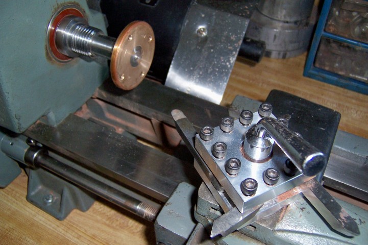

April 28, 201115 yr comment_46434 Bob.. Found another image of my Metal Lathe. This time without anything on the # 2 Morse taper holder I made. The square turret shows well. Larry  Report
