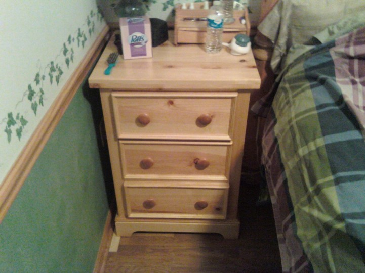

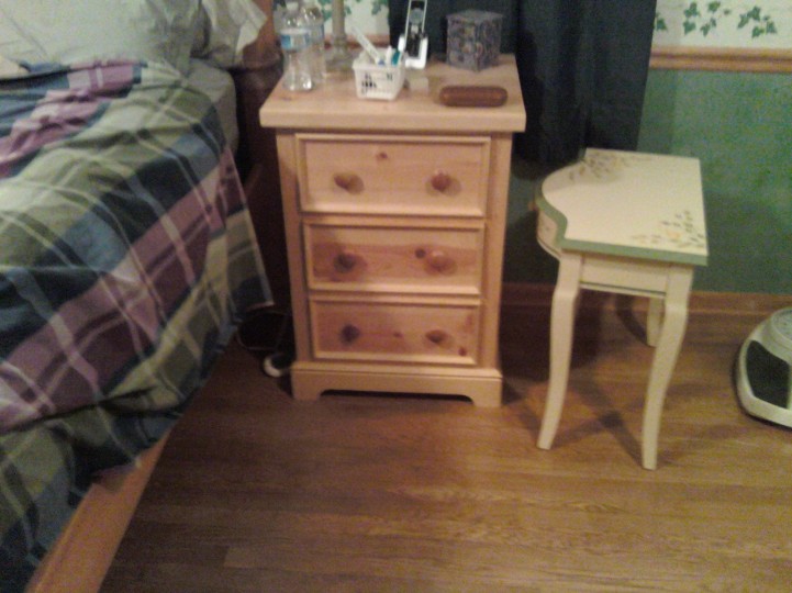

Actually I need  to show some of my work.
here are the night stand/chests of drawers built to compliment our bedroom set.
ning-nightstand1-46428-84.jpg?width=721ning-nightstand2-46428-8.jpg?width=721

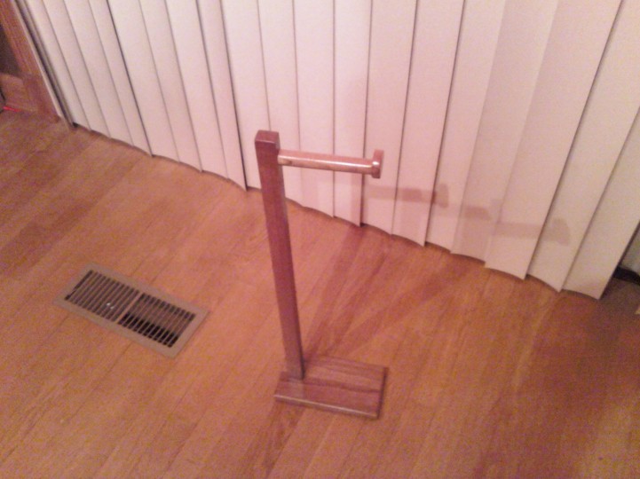

and as no job is done till the paperwork is complete here is the TP holder I made for our new Travel Trailer
ning-tpholder-46428-99.jpg?width=721
Man beautiful night stands...how did you finish them? Did you turn the drawer pulls, as well?
Overkill on the TP stand Grin.gifGrin.gifGrin.gif  that's made for 2 ply rolls 24.gif
I need to make one of those stands...our camper never came with a holder. Our TP usually ends up falling into the wet sink or tub.

Very nice John, thanks for sharing.
Very nice John. What were the night stand made out of ?
Really like they way they look.

The nightstands are made from pine construction lumber that I bought, stacked and air dried for 18 months pior to use. finish is just 3 coats of semi-gloss poly wet sanded and waxed
THe TP holder is Cherry with rattle can laquer. To make the base heavier I added 3 lbs of plumbum epoxied into counterbores. before applying some self stick hobby foam to cushion the floor and restrict sliding.
