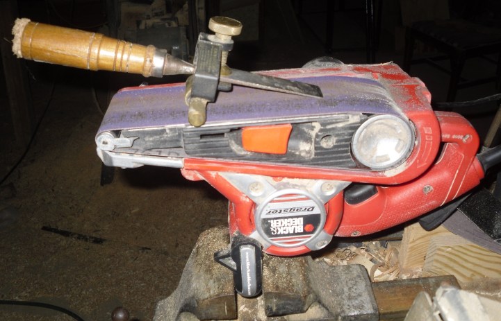

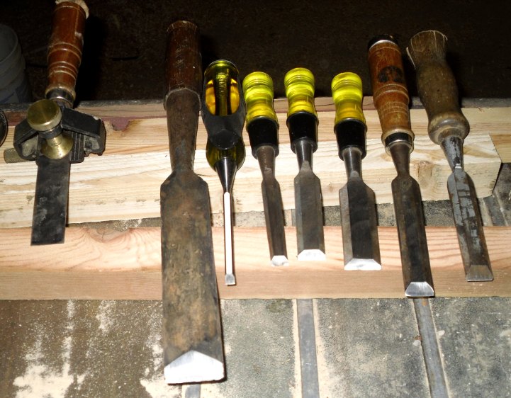

May 1, 201115 yr comment_46284 I have the set-up from Veritas.  Just a honing guide, and a plate guide to set some angles with.    With a chisel in the guide, set at the angle I think it should be, it's off to my beltsander. once the edge looks good with this set-up, I leave the chisel in the guide, and use my oil stones.  Guide has indexes so I can add a micro bevel to the edge.  Belt is just a new 100 grit.  I keep a fingertip on the chisel as I'm "grinding" with the sander.  Too hot for the fingertip?   I just lift the chisel up.  When it is cool again, back to grinding. Some of the "victums"... Report
May 1, 201115 yr Author comment_46283 SteveThank you. You are the second person to use or mention Veritas. Starting to sound llike a good investment. The photos show more then words and I greatly appreciate that. I'm just tired of throwing money away on chisels and plane irons etc. Which translates into JOhn's opinion which I do respect and yours. That makes 2 with recomendations and that is what I was looking for. So thank you again.As alays I am open to other opinions and suggestions are greatly appreciated.Best WishesWayne Report
May 1, 201115 yr comment_46282 Just a couple notes here:  I can lock the switch of the sander in the "On" position, and set the sander up with the belt running AWAY from me. That is a "cheap" 100 grit belt ($.95) on the sander. It does lose a bit of "bite" after a bit.  I keep both hands on the guide, with a fingertip from each hand on the blade itself.  The belt tends to make the guide, and chisel move around a bit, so both hands are for controling the "grinding".   These chisels were set-up to about 25 degrees , the plate that came with my guide has indexes for each angle.  I also "lap" the back by holding the chisel flat on the belt, again with the belt running away from the edge of the blade.  Safer that way. Wayne Mahler said: Steve Thank you. You are the second person to use or mention Veritas. Starting to sound llike a good investment. The photos show more then words and I greatly appreciate that. I'm just tired of throwing money away on chisels and plane irons etc. Which translates into JOhn's opinion which I do respect and yours. That makes 2 with recomendations and that is what I was looking for. So thank you again. As alays I am open to other opinions and suggestions are greatly appreciated. Best Wishes Wayne  Report
