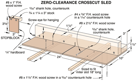

May 9, 201115 yr comment_45866 Well, I finished my first project with my new Bosch table saw this weekend. It was a pyramid type trellis for my wife. Thought I would try to finish it for Mothers Day. She loved it. During the process though I came to realize I need a crosscut sled. It would have gone much faster if I would have had one. I thought I had a set of plans for building one but I cannot find it anywhere. Does anyone have a set of plans for a crosscut sled they would care to share with me.ThanksDan Report
May 9, 201115 yr comment_45879 I got this over at WOOD Dan. There are many free cross cut plans available, I will look for some more! Â Report
May 9, 201115 yr comment_45878 Here is a really nice one to build This one found at American Woodworker Magazine. Click HERE to be sent to the actual article on how to build this cool sled. Report

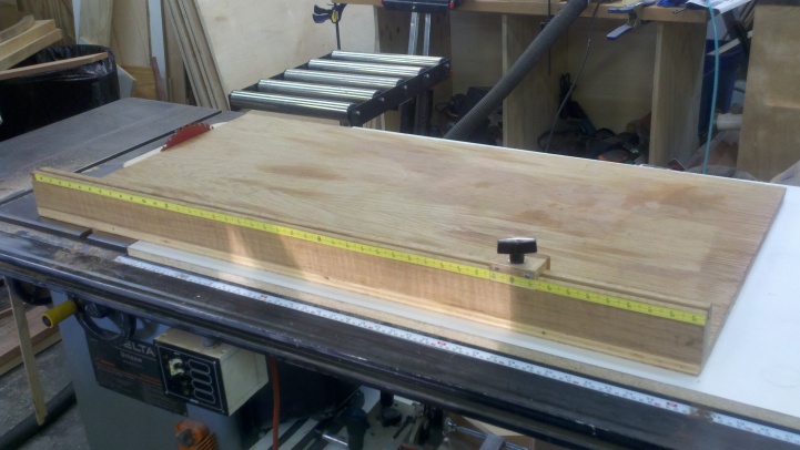

May 9, 201115 yr comment_45877 Mine looks like John's but the back and front are maple boards. Report
May 9, 201115 yr Author comment_45876 Thanks John, that is the one I was looking for. I will give it a try.Dan Report

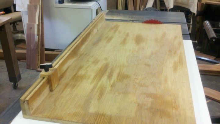

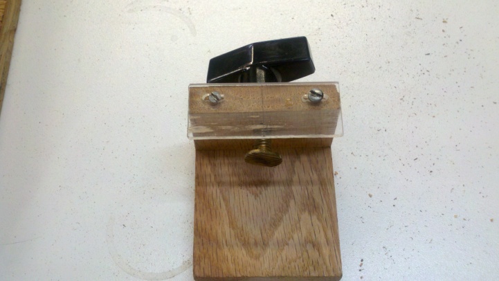

May 10, 201115 yr comment_45872 Dan, here are a few pictures of one of the cross cut sleds I built and use. Â Here is a closeup of the stop. Â There is a slot cut in the top edge for the bolt to fit into to slide across the fence. Â The fence is oak and the bottom is 3/4" ply. Report

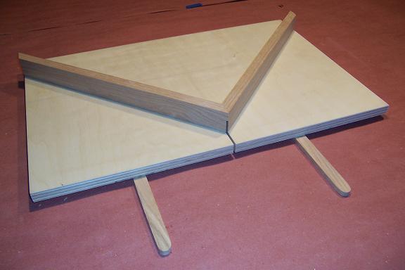

May 11, 201115 yr comment_45869 Here's one I whipped up one afternoon that cuts miters. By using both sides, the "laws of compensation" take over nicely. Larry  Report
May 11, 201115 yr comment_45868 I like that one Larry, I have been meaning for sometime to make one of those and just can't seem to find my "Round ToIt".  John  Larry Jenkins said: Here's one I whipped up one afternoon that cuts miters. By using both sides, the "laws of compensation" take over nicely. Larry  Report
May 27, 201115 yr comment_45867 I know people rarely use RAS's anymore, but a fixture similar to Larry's is probably the best way to make miters on the RAS.Dan Coleman Report
