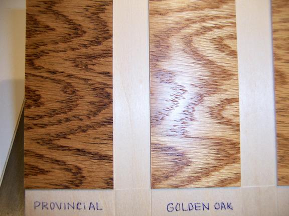

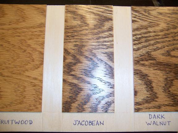

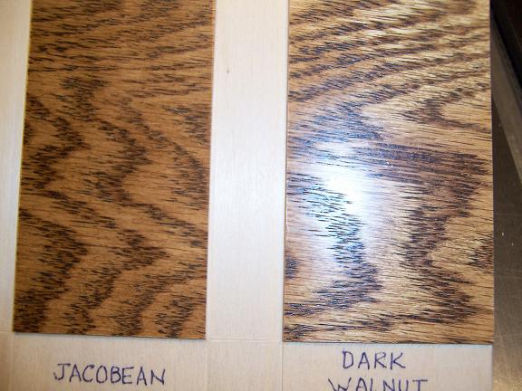

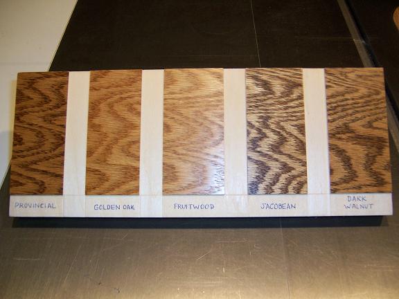

May 12, 201115 yr comment_45784 Last night, Ron and I were taling about what stain he wants to use on a Curio Cabinet he's going to design and build.  He likes the darker colors (so do I) and I mentioned Minwax "Jacobean." It's a little darker than the Provincial Ron likes, so I told him I would post some images of my Sample Board.  The Sample Board was made from a piece of highly figured Red Oak plywood to show the color contrasts for each stain.  Here's four images. Larry     Report
May 13, 201115 yr comment_45789 Great pics Larry and taking the time to work up some samples. Â I have found going dark stain in oaks. The pigments tend to collect in the deep grain and get thick or grainy looking. I have first used shellac,about 1/2 pound cut to say about 1 pound cut first. Then scuff the shellac with 320 so not to seal your color going into the wood. The shellac remains in the grain. Then apply your stain. Â The shellac will limit the amount of pigments taken up by grain. Will make the grain thinner looking. Play with some samples before taking it to the project, may take 2 coat of shellac with a light scuff between coats. Â Just a thought and perhaps something different to try. Â -Ace- Report
May 13, 201115 yr comment_45788 Thanks for the comments.That works. You are really using shellac as a "Conditioner".Some folks like the deeper contrast that stain on Red Oak will give you. Others like the "filled" look.I have rubbed out Zinnser's "Seal Coat" which is a de-waxed shellac with good results.What ever works..Larry Report
