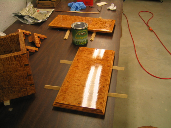

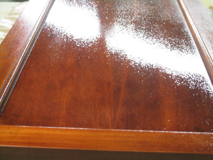

Hey John...I have found spraying water-based. It's best to apply the first few coats just a wee bit thinner and not piled on high. After a few light coats. Then spray a good full wet coat. I like to see the finish turn a little bit blue and looks orange peel. Then sit back and enjoy the show. Will flow out flat and smooth. Water-based take a few times to get the hang of it, but nothing anyone can't handle.
ning-img-3666-45672-19.jpg?width=721
ning-img-3433-45672-98.jpg?width=721
The top photo is Targets EM6000 and the bottom pic is General Finishes High Performance.
-Ace-
That bottom photo looks like a great finish.
