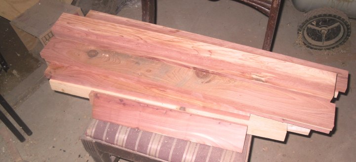

May 16, 201115 yr comment_45591  FINALLY!    A birthday "present" to me.   About five hours out at the "Barn".    Milled down two of the 8/4 by 6" by 16' Red Cedar boards.   One more to go, tomorrow, maybe.   Started by cutting those LONG A@@ boards down to a more managable length.    About 30" was used.  From there, it was off to the tablesaw.  Mitersaw did the first cuts. I ripped the 6" wide planks in half, then stood them up on edge and ripped them again into 3/4" thick slabs. There was still some rough edges, so a re-set of the fence, and all were cleaned up.  Next, started milling up corner posts.  These were about 26" long, by just under 3" wide.   I had a pattern to make a foot cut-out, so I laid out the cuts.   Over to the Delta bandsaw, adjusted the tension on the blade and cut out some feet. Set these aside, for now. Rails, a bunch of them. again about 3" wide.  I needed six long rails, and six short rails. Once cut to length, a groove was dado-ed along one edge on some, and both edges on others. About 1/2" deep, by 1/4" wide.  Then tenons were "nibbled" on each end.    Back to those corner posts.  They also have a groove along one edge, same as above.  Now the tricky part.   There also is a groove on one "face" of four of the posts, to match a tongue on the other four posts.  When done, this will be how the corners are joined to make the case.  Yes, there are pictures on the way.   Just getting on the computer when I get down here. Oh yes, also glued up a top for this Blanket chest.   Chest will also have a drawer in the bottom half. Frame and panel sides, with the drawer front milled to match the panels.  Should be FUN. Report

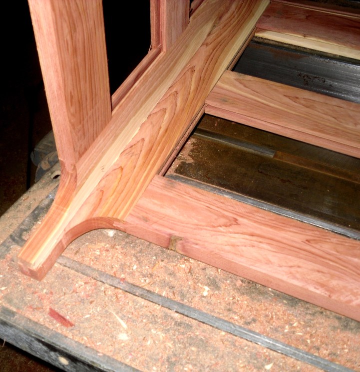

May 16, 201115 yr Author comment_45602 Ah yes, pictures...A test fit of the corner posts, and a few rails.    Now you see what the feet look like. Report

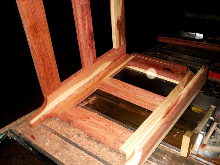

May 16, 201115 yr Author comment_45601 Another view... A close-up of those feet, showing the T&G joint used. The center rail has grooves on both edges, to hold the panels I've yet to glue up (tomorrow, I hope) Report

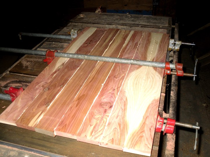

May 16, 201115 yr Author comment_45600 And that top. Yes the is glue showing, I will take that off when I level the top's surfaceWild a@@ grain, that Cedar has. Lots of sap wood, but that gives a bit more interesting look. Now a look at what all this came from.. Report
May 16, 201115 yr comment_45599 Steve that is looking really good, your right, that grain is way cool, how your panels going to be made, raised? Report
May 16, 201115 yr comment_45598 Wow that grain is kaleidoscope...can't wait to see more  -Ace- Report
May 16, 201115 yr comment_45596 I think you are already having fun. That should be one nice project for yourself. We need that once in a while. Thanks for sharing. Leosteven newman said: And that top. Yes the is glue showing, I will take that off when I level the top's surfaceWild a@@ grain, that Cedar has. Lots of sap wood, but that gives a bit more interesting look. Now a look at what all this came from.. Report
May 16, 201115 yr Author comment_45595  Panels are "planned" to be Shaker Style" in that a rabbet is run around the outside edges, then a bevel cut of about 5-10 degrees is cut on the raised part.    All done on the tablesaw.  That in itself aught to produce a story..  I've got the end panels ready to glue up (today?) just need to mill the last big plank for the rest of the stuff.    I also need a web-frame/ guide for the drawer.  Might be two drawers, as nothing is set in stone right now.   I've got some 3/4 plywood for the storage area's bottom.   Drawer bottoms are another matter... Drawer sides MIGHT be ceadr, or just pine, uncertain as of yet.  Brain cells are working a bit slow, nowadays... Report
