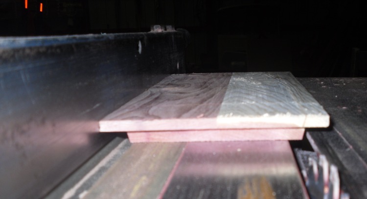

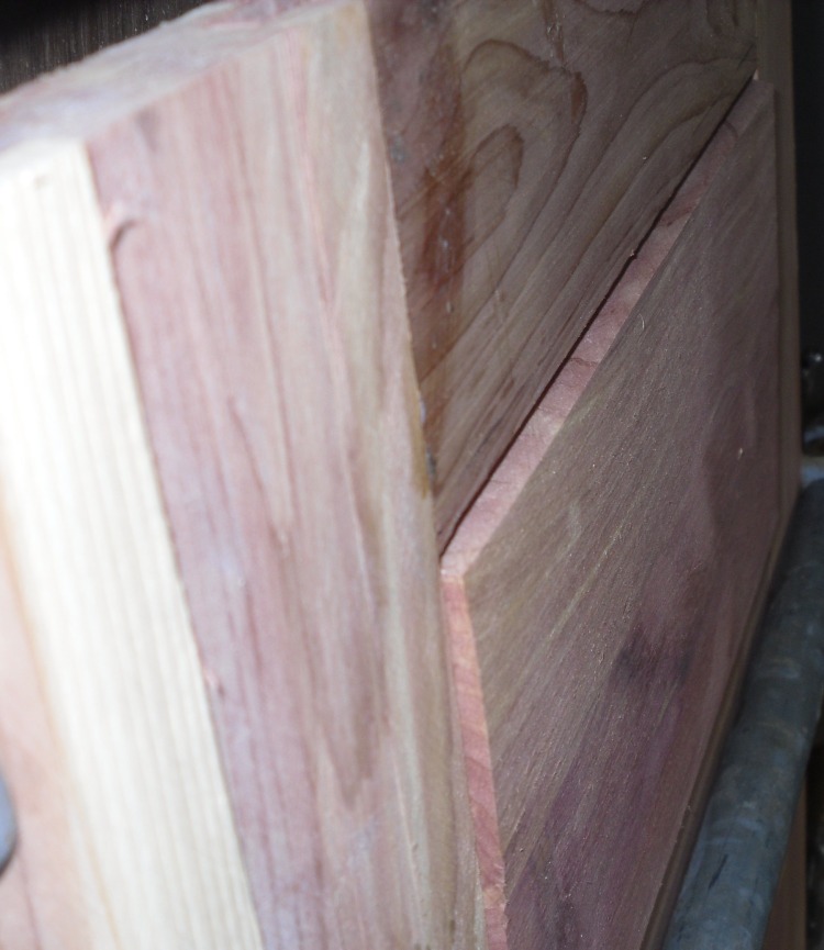

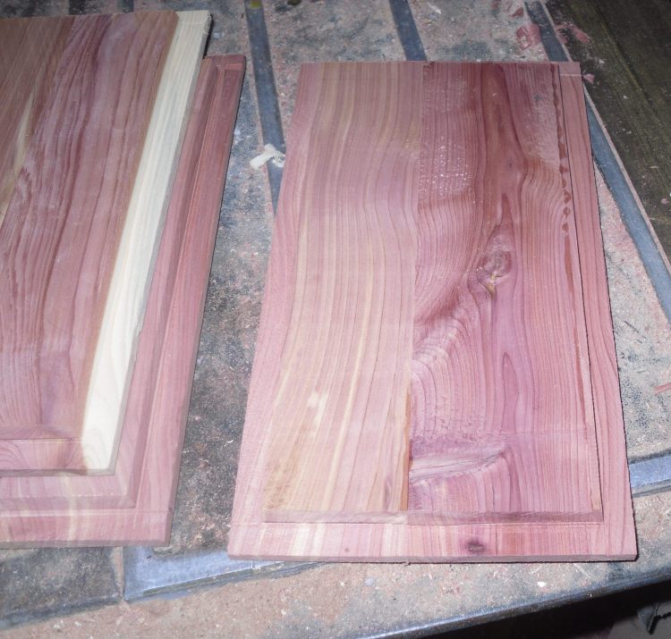

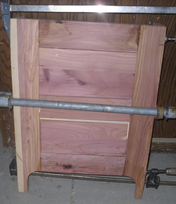

Next up some raised panels ON the tablesaw.  Once the panels were cut to size, a rip cut was done around the edges.   Panel was held vertical, and run through.   Next a re-set of the blade, to 10 degrees, a mark where the first cut stopped, and run that through.  This did the ends.   The long sides were done with the rip fence:ning-012-45501-33.jpg?width=750Just take your time to get the layouts right, and you wind up with:ning-013-45501-59.jpg?width=750These were for the end panels.   Two @ 6" wide, and two @ 5-1/4" wide.  About 11" long, or so. ning-015-45501-90.jpg?width=750One end panel in the clamps.  The raised panels just float along.ning-0162-45501-80.jpg?width=750They will stand a might proud, but that's alright.
