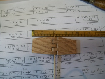

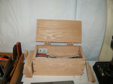

June 4, 201115 yr comment_44986 Since you made hand cut dovetails why not make some box joint hinges? Â I guess I would consider the use of the box and where it will be used. I made these hinges partly because I wanted to try it and also because I wanted the lid attached rather than something that could get lost in the shuffle on my side bench. The box is a little bit of a catch all for things I want close yet contained. Report

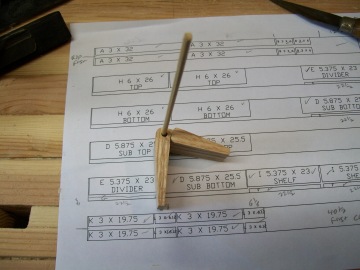

June 4, 201115 yr comment_44984 Thanks Randall. I used the dowel in the picture. This was my first attempt and the pin was sloppy so I used more care in drilling the ones I used on the box.Randall Farris said: Mark, Very nice indeed. What are you using for you pins? Report
June 5, 201115 yr comment_44982 Been wanting to try wooden hinges. Just haven't taken the time to do it. Yours look great. Report
June 5, 201115 yr comment_44981 Thanks guys. Try Google Images and enter wooden hinges if you want to see some awesome hinges. Mark Report
