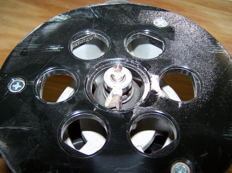

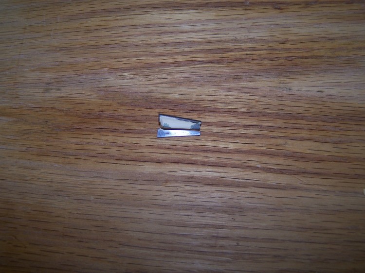

June 7, 201115 yr comment_44863 I was routing the dovetails last week for another cedar chest. I had just got started and routed just a few pins and the router bit broke right below the bearing. Â I have only made about three cedar chest with this bit. I was going to call customer service today, but they were closed when I got a chance to make the call. I guess that will be on my list for tomorrow. Â Have any of you ever had a fairly new router bit just break off. The bad thing is they sell it in a set witt the straight bit and it is 39.99. Â I'll let you all know what they do about it. Â Report

June 7, 201115 yr comment_44874 John, I have never had a router bit break like that. I have even run some router bits through pressure treated lumber on some projects that burnt the edges down completely, but never a complete failure like you had. Lucky that you weren't injured by that projectile. Report
June 7, 201115 yr comment_44873 It can happen. Don't know the maker of the bits, but dovetails are hard. The little narrow neck is the weak point. Ace has a good point. Did you go through any knots? I use dovetail bits alot. It has happened with whiteside bits to me. Not that it is unexpected. The straight bit does help. I hope the company stands behind the bits for you. Bob Kloeswww.bobkloes.com Report

June 7, 201115 yr Author comment_44871 I was standing behind the piece I was routing so the piece that broke off was on the other side of the board. There were no knots in the piece I was working on. They do sometimes end up on the ends, but I usually try to cut it so I don't have any knots in the dovetails. These bits are from Peachtree Woodworking Supply. I bought their jig at one of the Woodworking Shows and the bits came with it. I'll let you all know what they say. Giving them a call this morning.  Report

June 7, 201115 yr comment_44869 The color looked strange in the bit. Is the blue on it from heat? It broke right below the carbide at the weakest point. 40$ is really inexpensive for a set of bits. I am sure they were not whiteside, but I would try and look at the specs and see if you can buy bits that match from someone else, like whiteside or cmt, I have bits that have cut almost a thousand dovetails and they keep cutting along. Bob Kloeswww.bobkloes.com Report
June 8, 201115 yr Author comment_44867 Bob that is what I tried to tell them today, that a bit should last longer than to make three chest and cut maybe 150 pins. I am not sure about the heat, the bearing it loose and free so it shouldn't have been under any undo strain. I take it pretty slow cutting them in the cedar to keep it from chipping out since it is so soft. I am using them in a PC 690 router. Along the cutting edge is just where the paint has worn off. Â I'll look around and see what other bits I can find. These have a 5/8" bearing so it rides inside the jig. Bob Kloes said: The color looked strange in the bit. Is the blue on it from heat? It broke right below the carbide at the weakest point. 40$ is really inexpensive for a set of bits. I am sure they were not whiteside, but I would try and look at the specs and see if you can buy bits that match from someone else, like whiteside or cmt, I have bits that have cut almost a thousand dovetails and they keep cutting along.Bob Kloeswww.bobkloes.com Report

June 8, 201115 yr comment_44865 John, you can match the bit and then put a bearing and stop collar on. I have done that for some keller bits over the years. Works fine. You might even be able to find a match. Whiteside makes a lot of bits. Good luck and I hope you do well. bob Bob Kloeswww.bobkloes.com Report
