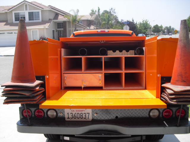

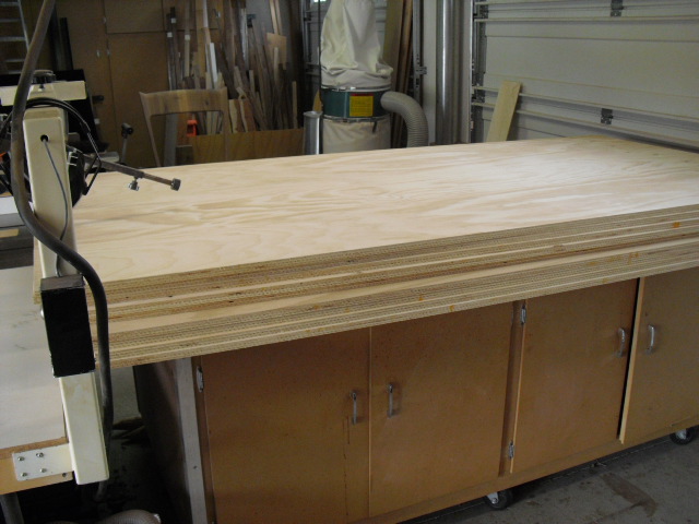

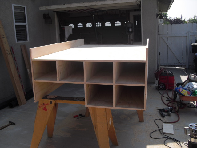

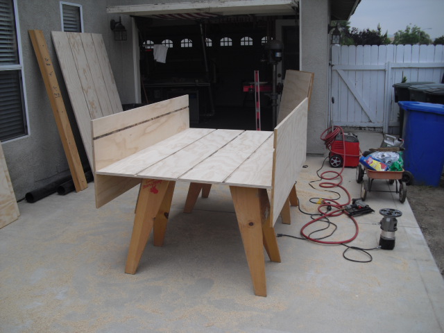

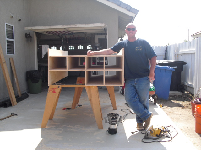

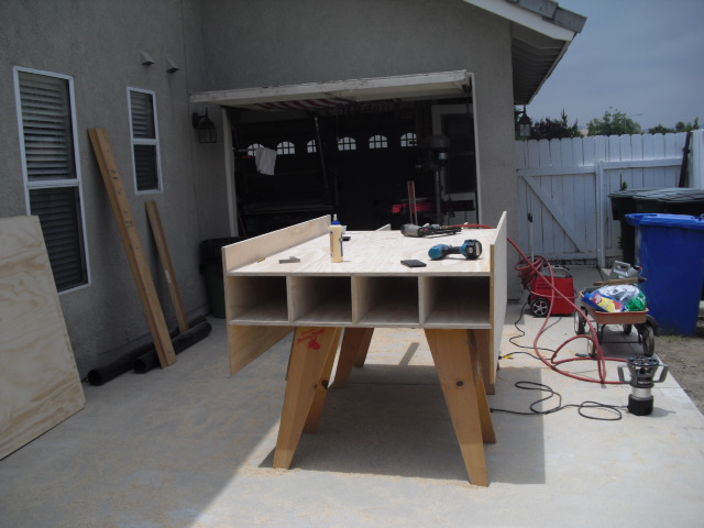

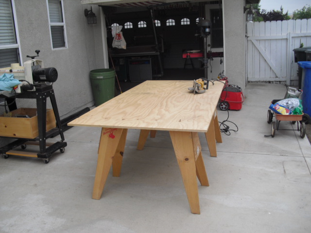

June 9, 201115 yr comment_44814 I have built about 12 of these boxes through the last few years for our company survey trucks. And I've been at it again today, the boss sent me home and told me to build a box! So, here are some progress shots of our truck boxes. In the lower left there will be a drawer for the lath. The upper cubbies are for the tripods, and the lower right cubbies are for digging tools and misc. There will be some upper tubes that hold our "Survey Crew" signs, and cradles that hold our rods. I been on this one since this morning. I forgot how nice it is to just work with sheet goods and a pocket full of galvanized screws and glue. It's brain free work, just fun to cut straight lines again. Â A big stack of ply wood soon to be a big ol box. cross cutting the sheets to 6' in length, the bed of the truck is 8' but we want 2 in the clear for GPS equipment. Dados cut and sides screwed in Taking shape! Almost there! And I'm done for the day! I will finish the box tomorrow, I need to go into work first in the morning and take care of some business, then I'll drive the new company truck back home tomorrow morning, build the drawer, and put some finishing touches on the box and I'll post the final pics tomorrow afternoon. Thanks for looking guys! Â Report

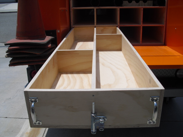

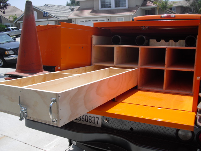

June 9, 201115 yr Author comment_44824 Thanks Rob, yep, not glamorous at all. To tell you the truth, I feel right at home banging cabinets together, cuttin dados and making things square. I did that for years. I made this box just like I made the others, out of my head. No jigs, well I take that back, I use my dado straight edge for my PC 7518 Router. It's a 6' long straight edge and guide I made specifically for the PC and a 3/4 dado bit. I have had it forever. I will show the details you want Rob, but as you say, it taing gonna be glamorous, clean yes, but nothing fancy, rob durfos said: Ah , the less glamorous side of wood working that fits form and function . Did you make jigs up along the way for future use ? A good post - please show the drawer details . Thanks John MorrisThe Patriot Woodworker Report

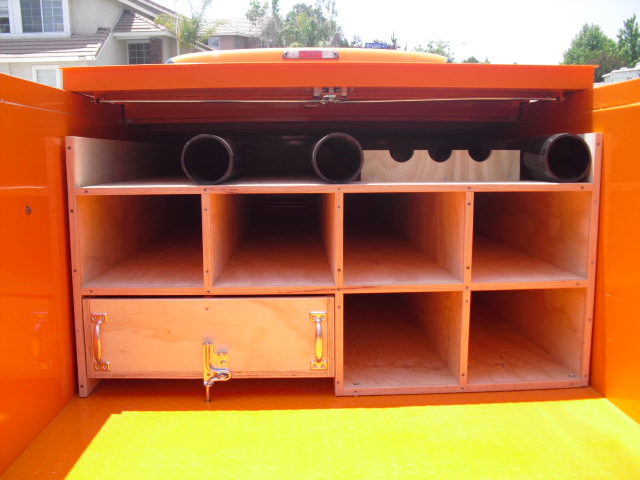

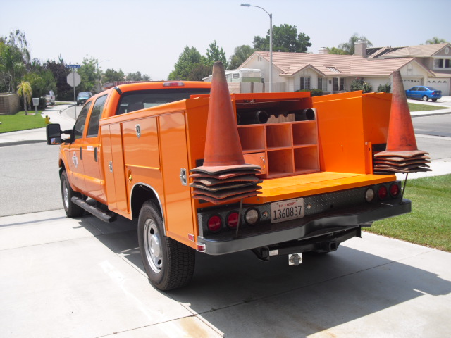

June 10, 201115 yr Author comment_44819 Here is the finished box folks. Rob, I hope the drawer layout is what you were interested in. I tried to get some good pics of the drawer. The ABS tubes on the left are for the "Survey Crew" signs, they are rolled up and shoved into the tubes. The cradles to the right of the two abs tubes are for rods, the abs to the right of that is for misc rods. The middle cubbies are for tripods, metal detectors, etc, the lower two cubbies are for digging implements and asphalt breaker bars. The roll out drawer is for our 2' and 4' lath. We keep our hubs in one of the side cabs with the paint. The space between the tail gate and the box is for our GPS equipment, and the occasional use of a Whacker brand type of gas powered jack hammer we use to dig up center line road monuments. So there ya have it folks! 1 each survey box! Thanks for looking. Oh yeah! Between the two ABS tubes on the left we slide in our sign standards. John MorrisThe Patriot Woodworker Report
