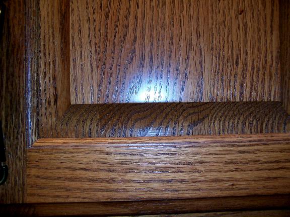

June 13, 201115 yr comment_44716 Thanks for the honesty, Ron..  The grain patterns on solid Red Oak will change directions when the surface profile changes. Here's an image of one of our kitchen cabinet doors that shows the grain direction change quite well.   Some time ago, the Japanese perfected a way to apply thin red oak veneer on MDF raised cabinet door faces using a vacuum process. Although the veneer comforms ro the surfaces quite nicely, the grain patterns, going into the contour changes, remain quite straight. Your Amish supplier had to buy the doors for resale. I would doubt that they have the means to produce them. There is a positive to this discussion. Raised panel doors made this way are very stable due to the MDF cores.  Sorry for picken on ya, but I do like to share trivial information.  Larry Report

June 13, 201115 yr comment_44713 John1.. For future jobs like that, just look at the grain patterns on the Raised panel doors. One of my biggest thrills was when I convinced a Builder that he had bought veneered raised panel doors. He was totally unaware of them. Bet he thought I was a real posterior orifce. Get in line..  Larry Report
