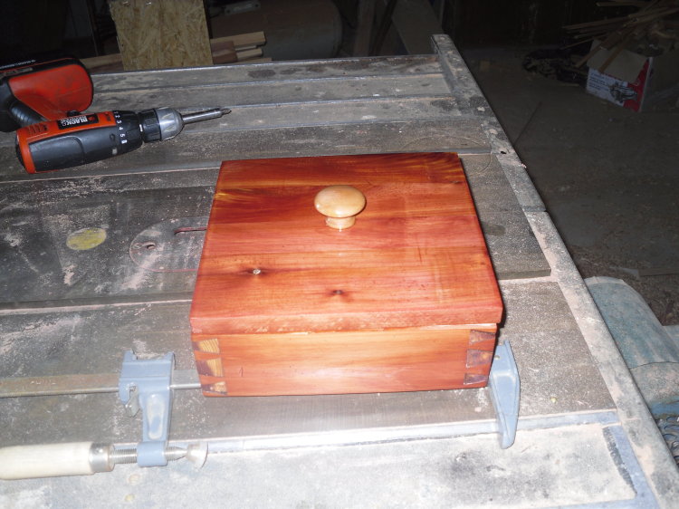

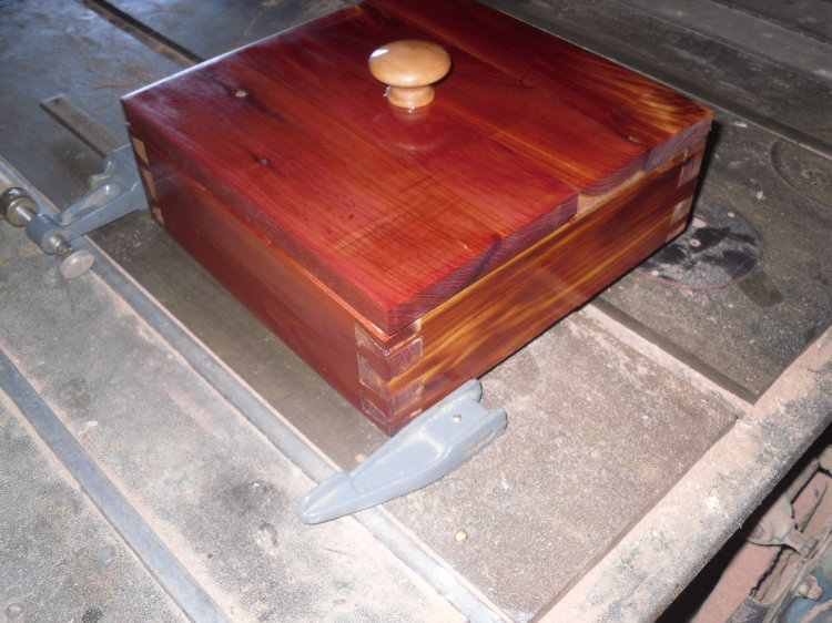

June 13, 201115 yr comment_44698 Just a few looks at what I came up with for those leftovers from the Cedar Chest.Ain't they purdy?Just a little 10" by 10" box.  Clamp is there to keep the box off the tabletop while I varnished it.  Not too bad for the first try at these handcut dovetails? I used both a bandsaw, and a backsaw, to cut things out.  Cleaned up with a chisel. and sanded flush.  Knob was a leftover from another job, centered on the lid.  Sorry Ralph, too small for a breadboard edge on this one. Report

June 13, 201115 yr Author comment_44703  That old Stanley backsaw had a kink in the blade, had to straighten the thing out.   Then I took an oil stone to the blade. Just ran right alongside the teeth.  At the end of a cut, I can let go of the saw, and it will stay there, no wiggles.  I basically took 99% of the "set" out of the saw's teeth.    As for chopping out the waste, a couple chops on one side, then the rest of the chops were done from the other side. No "saw guide" was used, other than an old set of "Mark 1" eyeballs.     Normally, when I handsaw some wood, I split the line ( a habit of mine) but on dovetails, I soon learned to leave the line. After the first ones, I started to mark WHICH side was the WASTE side of the lines, and to leave the lines intact. Kind of hard to break old habits. What I could cut on the bandsaw, I used that.  The other cuts were done in my vise by hand.  Practice, practice,and more practice, sheesh!.    I used a bit more glue than needed, and used some sanding dust to fill in the "bad" dovetails.  Everything was then sanded down flush.  Again, this was my First set of these things.  Maybe not the last, we'll see.... Report
June 16, 201115 yr Author comment_44702  I still have plenty of that scrap left, maybe a few more boxes?   Maybe some better (finer) dovetails?    I just picked up a second Stanley backsaw, this one doesn't have a kink in it.  That trick with the oil stone does remove some of the "set" in the teeth, but what remains makes for a sharper blade. No wobble, either.  Biggest thing I've found out, was to mark ALL sides of the board.  Marked with....just a very sharp pencil.  While it might be nice to "knife" the marks, I can't see them. I'll keep at this little skill, maybe I MIGHT get a wee bit better as I go along.   I figure I'm about halfway down that LONG, SLIPPERY SLOPE to becoming a Neanderthal Woodworker.  No electrons are needed down there, just plenty a MANUAL energy.  It might even be FUN! Report
