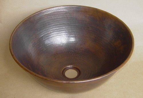

Here is a photo of the type of vessel/bowl/sink that we will be installing and it will sit on top of the counter top. It is made out of hammered copper and is 14" in diameter and about 6" deep. We will be ordering it from Amazon for about $100 which is far better than the $300+ that they sell retail out here in our neck of the woods. We now just have to decide on the faucet as we are limited due to the add height of the sink and I may have to make a pedestal to attach to the vanity top for the faucet to be mounted on. So I just gotta get all the parts together before I can move forward.

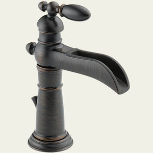

Here is a photo of what I am thinking about for a faucet design. We won't be getting this exact one but it is one I just pulled up quickly off the Delta Faucet site to give you an idea. We want to go with a single hole design as it will take up less space but it will depend on what we can find and the price as they get a tad expensive and we want to get it closer to the color of the vessel.
I really like the sink and faucet. That type faucet should go really well with what you are doing.

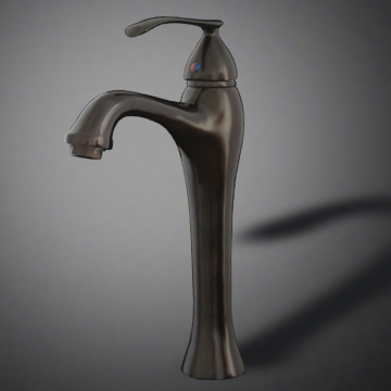

Last night my wife found and purchased the vessel faucet on e-bay for $75 (beats the daylights out of paying locally and online from $250-$300). It is a discontinued model made by Moen new in the box so it is good quality. Not as flashy as some of the other ones I was looking at, but saving $200 makes up for it.

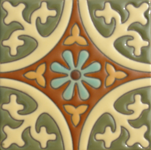

Yesterday my wife and I went out and looked for accent tile for the backsplash and found the ones that we wanted. I contacted the manufacturers showroom and was able to order direct from them as opposed to buying through a distributor for more money. They happend to be having a sale going through Monday so I was able to get them for an additional 30% off. The tiles are hand painted Mexican style accent tiles done in muted colors which will go nicely with the A&C style as well as tie into our overall Mission/Southwest/A&C style and designs in our downstairs. I will be putting in five 6"x6" tiles of the same design framing them into the backsplash. The place we got the tiles from is Classic Tile and Mosaic and the specific tile is FD-148
Wow, I love that tile. Very nice and the colors should really add to what you are doing. Can't wait to see them in place.
I also like the choice of faucet. With the copper vessel that should give it a very special feel.

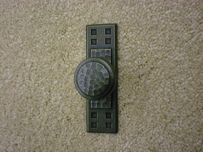

I also ordered my door pulls today from a specialy supplier online "HERE". Not bad on the pricing at $10 each but just what I was looking for. They had a lot of really nice designs for A&C, Mission, Southwest etc. so I bookmarked them in my "Favorites" for future projects.
