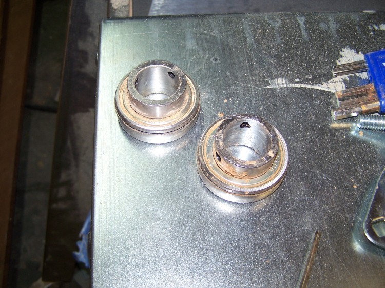

June 28, 201115 yr comment_44026 I spent much of Sunday afternoon sanding end grain cutting boards. I was on the last side of the eleventh board and the conveyor belt on the sander separated at the seem so I had to stop. I have a new belt on order. Right now it looks like two weeks before it gets here. I am going to be sooooo far behind. Â Anyway while I was sanding I kept hearing a clicking noise that I had not heard before when running the sander. I could rotate the drum by hand and here the clicking sound. I am assuming that I have a bearing going bad, so while waiting on the conveyor belt I decided to replace the bearings. Â Got the out tonight, boy was that a small task. Anyway I am glad I took them out since they look nothing like the picture I saw of the Jet model. Mine is an older Performax. Â Here is a picture of the bearings. Â Â I really hope I didn't take these out for nothing. I can't really hear the noise in the bearings since I have them off. I did secure the motor and turned it on while it was disconnected and no noise coming from it. Oh well they are off now and I am going to see if I can located new bearings tomorrow. I did purchase the sander used so knowing that it has new bearings will be okay too. Â The bearings have a number of SST 50285 so I'll see if I can finds some. Â Any of you had to replace bearings in your drum sander? How about the conveyor belt? Â John MoodyJohn Moody Woodworks Report
June 28, 201115 yr comment_44043 Any good bearing supply house should be able to match up what you need. Try and get something made in the US or japan.Not sure if they will come with the inner race installed or if you will have to push out the ones you have and reinstall them. If you do, be careful to only push on the race and not the shield of the bearing. The person at the bearing supply house should be able to tell you if they come that way. If you cannot find a bearing supply house in your town, try Accurate bearing online. For sandpaper, I buy mine at Industrial Abrasives.http://www.industrialabrasives.com/They should be able to match up your belt for the feed there . Great folks, small family run business. Excellent product.Bob Kloeswww.bobkloes.com Report
June 28, 201115 yr Author comment_44042 Thanks Bob, I will check them out. Â I am hoping they can match them up and make this simple so I can get it back together, adjusted and back to sanding. Â By the way it was just kinda funny. On the dust cover it says, "Performax, Fine tools made in the U.S.A." Â On the rim of the bearing is says, China. John MoodyJohn Moody Woodworkshttp://www.johnmoodywoodworks.com Report

June 28, 201115 yr Author comment_44040 Mike, no chain drive or belt drive. Comes right out the end of the motor, has a coupling that connects to the shaft. I ran the motor with nothing connected to it and no noise coming from it. I could turn the bearings after I removed them and not hear any noise. Today I went to two shop to purchase new bearings and the guys at both places seem to think the bearings were okay. Since I had it apart, I went ahead and purchased new bearings to put on it. The drum would bounce some when you turned it off and it ran down, but it was sanding fine. As flat as I could tell. I guess when I get everything back together we will see if there was anything left over in the way of noise.  John MoodyJohn Moody Woodworkshttp://www.johnmoodywoodworks.com Report

June 29, 201115 yr comment_44036 Here's a shocker Bob. John and I have been looking at the original bearings and according to the SST spec sheet, they're stainless. I didn't think you could harden stainless enough to make bearings from them. Learn something every day.Bob Kloes said: Hope it all goes well. Chinese bearings are big now. Most bearing companies have plants there. It all depends on the specs for the bearings. Like anything, crud can come from here as well as there. Hope your sander runs like a top when you get done. I use my woodmaster a lot and can say it is like a tank. I had an older 37" preformax and it was simple to run. I didn't like the double drum on it though. The new company is called superbrush , I believe. Started by former employees of prefomax.Bob Kloeswww.bobkloes.com Ron DudelstonAbove and Beyond WoodWorks Report

June 30, 201115 yr Author comment_44033 Well I didn't run across this information until today when I was actually reading the manual to get ready to put this back together and align everything. ROTATING DRUM BEARINGS Bearings should be replaced when they allow excessive play of the drum, make excessive noise, or otherwise indicate failure. Note that if clicking noises in the bearings are a problem, rotating may be a solution instead of replacement, Rotate as follows: 1. Loosen the set screws in the bearing collar (See Fig. 22) ~ Leave the Allen wrench in one of the set screws, Rotate the drum within the bearing and tighten the set screws. If unable to rotate drum, remove set screws, apply penetrating oil and let soak, then rotate shaft in bearing. 2. If the clicking persists) or if the drum shaft is tight in the bearing and cannot rotate, loosen the two bolts holding the bearing and the flange for the bearing. Now repeat Step 1 . .Aiter the drum is rotated within the bearing, tighten the flanges first and then the set screws. NOTE: It is necessary to realign the Tension Rollers after rotating the drum bearings (See Fig. 27). After the machine has run for one-half hour} stop to check that the set screws and bearing bolts are tight. Oh well, I already have the new bearings now so I will just replace them, but I hopefully will file this away for the future.  John MoodyJohn Moody Woodworkshttp://www.johnmoodywoodworks.com Report

July 3, 201115 yr Author comment_44027 Drum sander is back together. Still got a little bit of twiking to do, but for the most part all is good. I put the new bearing in and no more clicking. It runs a lot smoother also. Maybe it was worst than I realized. Also got the new conveyor belt on. Boy this one seems a lot lighter weight than the one that was on there. May explain why it was 49.00 instead of 93.00. I'll give it a try and if it doesn't last I will go with the more expensive one next time. I have got a little bit of adjustment to do on the guide roller in front of and behind the drum. I am seeing some very slight snipe. Didn't have that before, and it is very slight, so I am close, but I had a few other things to get done today, so I will go back to that tomorrow afternoon. Just glad to have it back and ready to run.John MoodyJohn Moody Woodworkshttp://www.johnmoodywoodworks.com Report
