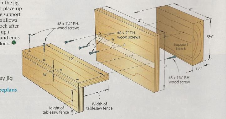

June 30, 201115 yr comment_43942 Good Morning Friends,We all know that making different jigs for different tools that would make the job much easier and more efficient.What would you make that would make cutting raised panels on the table saw easier and safer? Report
June 30, 201115 yr comment_43948 I would make a sliding "saddle" to fit over the rip fence. It would have a high side (at least half as tall as the panels long side) nearest the blade. It would had a cleat at the rear that was perpendicular to the saw table to act as a 90 degree rear stop. It would have slots/holes placed strategically to allow clamping of the panel during the cutting phase. Report

July 1, 201115 yr Author comment_43943 Good Morning Fellows, Mine is like the first poster and we used it yesterday for cutting tenons of 1/2" x 2 1/4" high. My new apprentice admitted that he was a little intimidated of the table saw how ever I was able to get him to over look his feelings and showed him how he would not gut hurt. Now for the picture of the jig. Report
