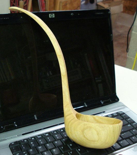

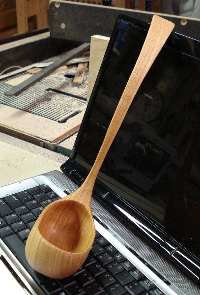

July 2, 201115 yr comment_43864 My buddy took my last 2 rolling pins to sell in his store in Lexington, Va. I have been trying to replenish my stock but it takes a while to glue up the blanks- about 9 hours per blank start to finish. Just messing around with a piece of Honey Locust given to me by a former student and co-worker. Surely wish I had some creative bones in this old body. Seems everything looks very primitive. But it works- Â Â Â Report

July 2, 201115 yr comment_43873 I like primitive! Looks great Lew, now, care to explain how you made it? John MorrisThe Patriot Woodworker Report
July 4, 201115 yr Author comment_43872 The general shape was cut on a band saw. Not sure what the technical name for the process is but it is the same type of cut used to make cambriole table legs. You cut the piece twice. First the side shape then tape the waste back in place. Then cut the “end†shape. If that makes sense. So the handle is actually cut in that shape, not bent. Then it is just a lot of chiseling and sanding. The concave portion was the worst to complete. The majority of the material was hogged out with a Forstner bit and then used the only 2 gouges I had, to shape it. Smoothing it was the real challenge. Ended up using a curved scraper (looks like French Curve). John Morris said: I like primitive! Looks great Lew, now, care to explain how you made it?John MorrisThe Patriot Woodworker Report
