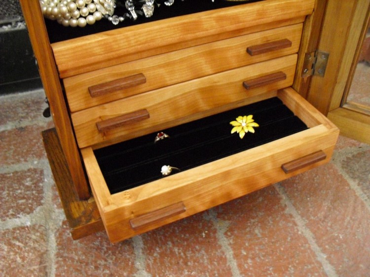

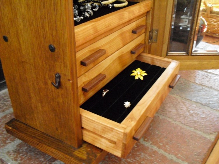

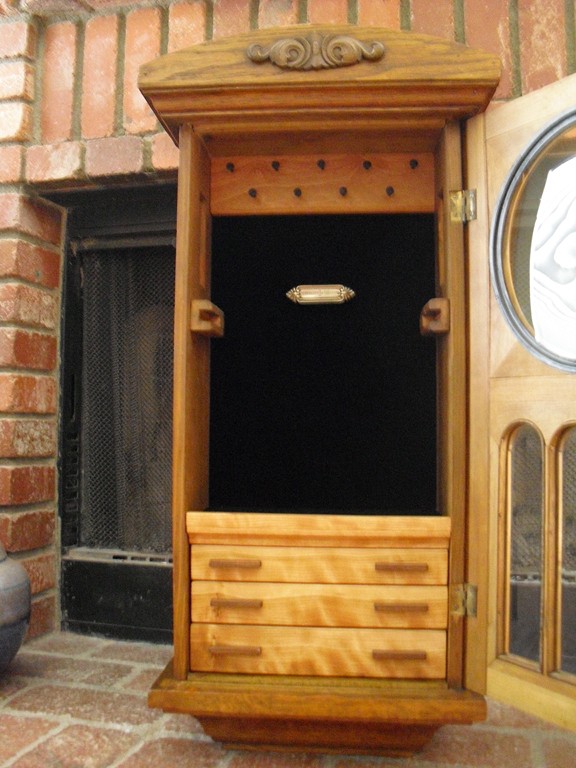

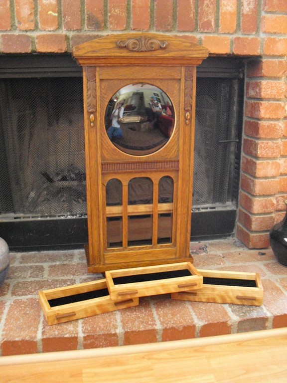

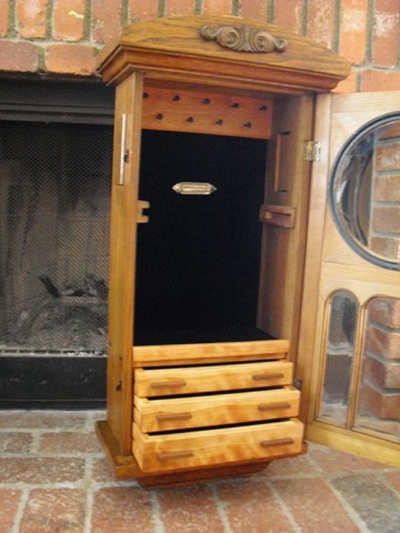

Well I finally got her done,between other jobs, our site, and life, I was able to squeeze this out for a buddy at work just in time for his wife's birthday dinner lastnight. I delivered it yesterday morning.
Here is the original discussion with pics of what I was attempting to do. Wall Clock Jewelry Case Conversion.
And here are some pics of the finished case.

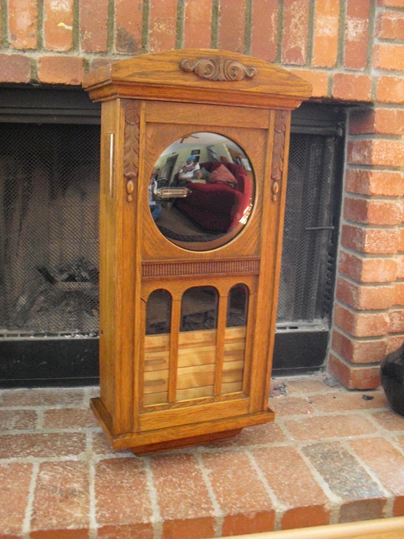

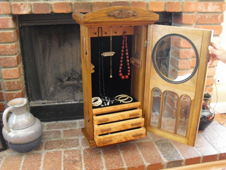

ning-yugoslavclockcasejewelrycase20-4384ning-yugoslavclockcasejewelrycase4-43841ning-yugoslavclockcasejewelrycase6-43841ning-yugoslavclockcasejewelrycase2-43841ning-yugoslavclockcasejewelrycase21-4384ning-yugoslavclockcasejewelrycase-43841-ning-yugoslavclockcasejewelrycase22-4384ning-yugoslavclockcasejewelrycase21-4384ning-yugoslavclockcasejewelrycase19-4384This was a fun project, one correction that I must make from the last post, this clock was made in Yugoslavia over a 100 years ago. Not Austria as I said in my OP.
This was a great idea the customer had, converting an old clock case that has been sitting in the rafters for decades, into something useful for his lovely wife.
Thanks for looking!

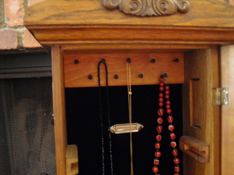

Thanks guys! And Wayne, I have you to thank for that idea about the ring holder. I cut the grooves in a block of wood, about 1/8th and then come a little plus, and then I glued velvet to the block, I took a straight edge and pushed the material in the grooves before the contact cement had a chance to set up. I did exactly as you said cept I didn't use flocking, I used the black velvet. Thanks Wayne! And thanks again guys for the kudos.
