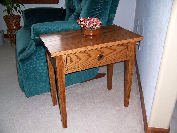

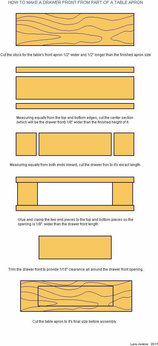

July 4, 201115 yr comment_43785 I chose this Forum because it's the most popular, and this post is more of a tutorial than plans. The following are progressive drawings of how to make a drawer front from part of a table apron. Following the drawings, I'll show you an image of a small chair-side table I designed and made using these methods. Larry    Lare.. Report

July 4, 201115 yr comment_43792 Hi Larry,That is a new slant on the project and it looks good. However I cut one out of the apron by cutting it out from the back side and when assembled it matched the apron perfectly. I would show a picture but, I forgot to upload the picture. Report
July 5, 201115 yr comment_43791 Ralph and others.. Thanks for the kind words.There are several ways to do this. I just like to do it this way because it gives you some latitude when doing the final sizing of the components. Lare.. Report
