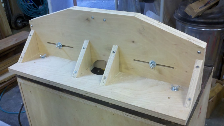

ning-20110705-193154-257-43727-85.jpg?wiSo I grabbed some plywood I had and got started.

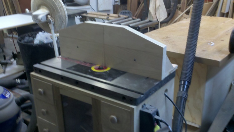

ning-20110705-193211-639-43727-58.jpg?wiI went everywhere here and couldn't find any knobs, so for now it has winged nuts. I also have a dust port ordered for the back.

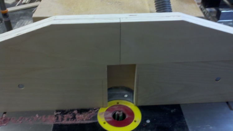

ning-20110705-193306-948-43727-36.jpg?wiThe front plates open and close for the bit size.

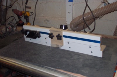

Nice job on the fence. I made mine for my router table too.  I used melamine and added some track for stops and put a bit cover over mine. This is what mine looks like. I also made it so the opening was two piece slides. Allowing a smaller opening for shorter bit but accommodates the taller ones also.
ning-dcp-0031-43731-69.jpg?width=400Not as tall it stands about 5 inches high. The dust collection works wonderfully though.
Wayne Mahler
Very nice Wayne. I like that. I will probably change the front pieces to Melamine. They are on there now so they are removable.
I didn't have any T track in the shop right now that is why I did it that way.

I like the tall fence. It gives you a place fot clamping feather boards and really adds to the work piece stability.
Thanks Lew, that is kinda what I had in mind as I put this together. I didn't have any melamine handy so I made the front faces to they could be removed. I will replace them with another face in the near future. I will also add some t track with I change them out.
