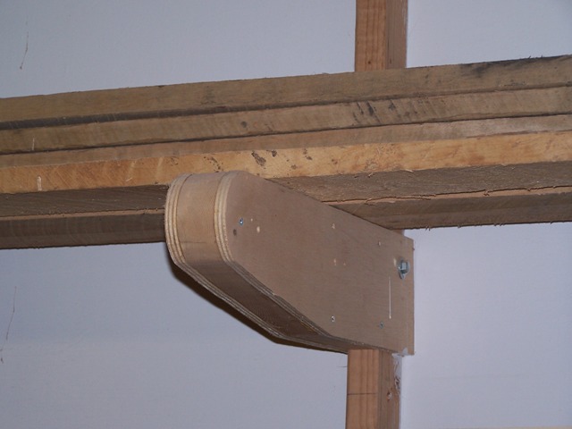

Here is a close up of the cantilever.
ning-lumberstorage3-43390-98.jpgIt is a 2x6 with two pieces of 3/4" plywood glued and screwed to each side. The plywood goes back an extra 3 1/2" to allow it to slip over the upright and the 2x6 butts up against it.

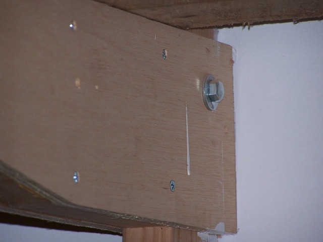

ning-lumberstorage1-43390-69.jpgThe bolt goes all the way through and has a nut on the other side. You can see the hole just below the cantilever so I can move them up or down.

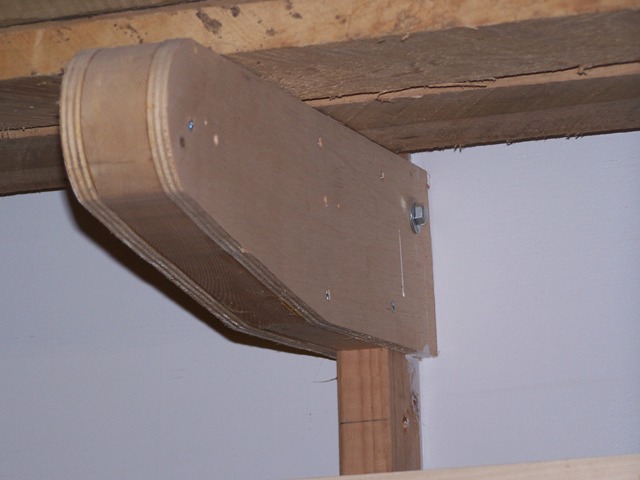

ning-lumberstorage2-43390-41.jpgThe cantilever is a 2x6 trimmed off and then rounded on the front. The plywood fits up tight against the wall.
I have had quite a load of lumber on there at times and the wall has held it pretty good.

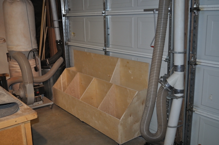

I am pretty limited with storage space but since I got a new shed and moved all non-shop related items out of the garage, it does make my life easier. I have 3 storage areas in my garage.

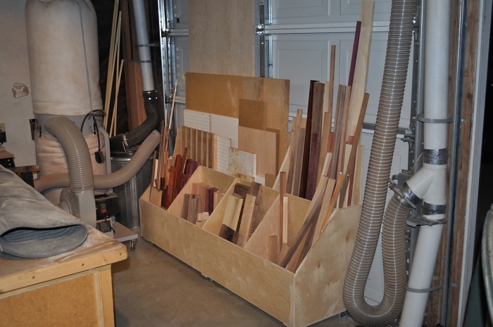

1. Rolling Scrap Cart to keep smaller pieces in order and out of the way.

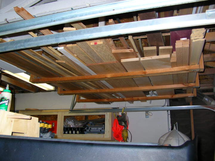

2. Overhead rack to keep larger pieces left over from other projects and stuff I just can't part with. (No, it is not bowed from the weight but it is due to lens perspective on wide angle)

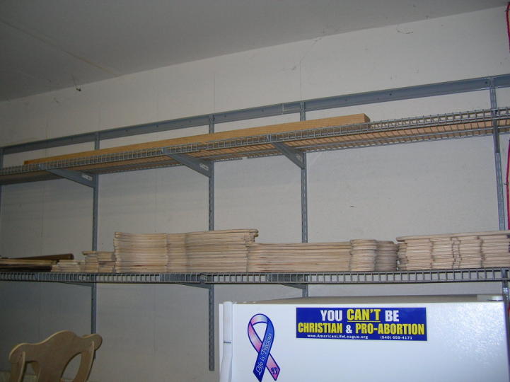

3. Two shelves for storage of my children's rocking chair pieces (bottom shelf) and for my current projects (upper shelf)

That is some very nice storage Allen, The cart for cuts off in front of the garage door, is it 8' long?
