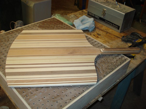

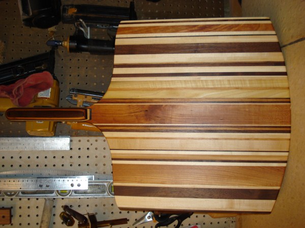

She is 19" square, about .4" thick, about 30" long- including that lovely appendage- and she is stacked !
Sorry about the risqué second photo, but she insisted on being photographed "nude".

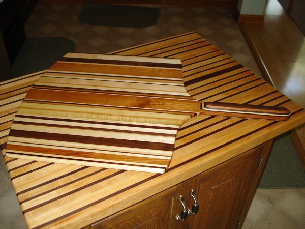

The next photo shows her getting ready for work, wearing several coats of mineral oil.

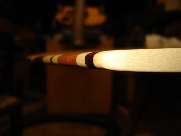

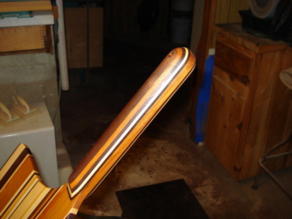

The forth photo- a close-up of her luscious lip followed by her slender appendage.

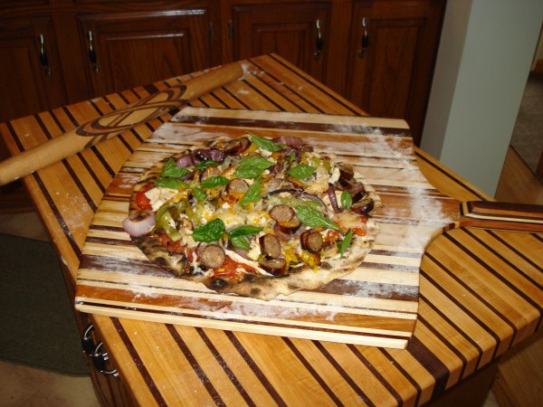

Finally, I got a shot of her in action-- Man she is HOT.

Actually, after making the last batch of rolling pins, I had a box full of cut off and pieces with defects. Just couldn't bring myself to throw them away so this is what they turned into. It was a simple glue up- in stages. The original design was to have a flat handle but that wasn't very comfortable. This design seems much more user friendly.

Bob,
There is a about a 2" taper at the end from full thickness to around 1/8" then rounded.

That was a point of discussion. Should it be left "dry" or have a finish. The mineral oil really brought out the grain but I needed to use quite a bit of corn meal to keep the dough from sticking. Maybe as it gets used it will work better.

well in practical terms for pizza peels, you've got several factors to deal with.
Wet dough has amazing sticking properties and left in contact with a surface it will readily bond to it like organic glue (which it is). There are several things you can do. Flour's fine mill helps create a uniform coating on the peel and acts as a block to the dough sticking to the peel as the water would rather stick to the flour. Cornmeal's coarse grain helps the pizza to slide around for ease of placement on the stone. So I'd recommend using both.
As to whether it's better oiled or not, the oiled will be easier to clean, but you may have issues with flour grabbing onto the oil (I haven't tried a peel that's been finished so don't quote me on that). A raw surface on the peel, means you can keep it floured, which would be very European.

Thanks for the information. I may just allow the board to "dry out" and not replenish the oil- like a cutting board or rolling pin. The color may fade but it should still look nice and work even better.
