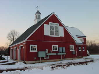

July 31, 201115 yr comment_42697 I went through the whole single phase/three phase dilemma when I built the house and barn eight years ago. My local utility (PSE&G) offered up three phase power at $60k for installation. I ended up sticking with single phase. Since I was building the service myself, I ran high voltage (13,500V) to a transformer right next to the barn. From the transformer, I ran copper cable (1250 kcmil) to the current transformers. From the CT cabinet, the service splits to two disconnects rated at 400 AMPS (one for the house and one for the barn). From the disconnect I go into a 400 AMP panel that services the shop.All of this adds up to a big ugly mess on the side of the barn. If I find some pictures, I'll add them to the thread. I had been rat holing three phase machines for a long time before this, so I already knew I needed a converter. I looked at buying one and just couldn't justify the cost. I needed a 20 HP, and prices at the time were staggering. I already had some NOS motors laying around so I went down the road of building my own. This was a bit of an experimental process for me. I ended up with a configuration that consists of a 20HP motor, a potential relay, a bunch of start caps, a bunch of run caps, a terminal strip and a steel enclosure bolted to the motor. The whole thing cost $160 to build (including the several start caps I burned up in the process). I installed this contraption under the stairs in the shop and haven't had to touch it in seven years. I have to start it from the breaker panel (no remotes), but this hasn't been much of a hassle.Coming out of the RPC, I go into a three phase panel. I also have transformers to get me to 480 and 600 volts for my Canadian/English machines.In the past few years I've also added some big VFD's to the mix. I was fortunate to come accross two Danfoss 10 HP VFD's that could be run from single phase. I use these to power the dust collector and some of my shapers that require 120 cycles for full speed.The bottom line here is that the RPC has been so reliable that I doubt that I would ever switch to three phase utility service unless it was at no cost. AFSomerset, New Jerseyhttp://www.owwm.net Report

August 4, 201115 yr comment_42694 As promised above, here is a picture of the side of the shop with the service entrance, current transformers and disconnects. Fortunately, this is not visible from the house side of the building. Â Â AF Somerset, New Jersey http://www.owwm.net Report
August 4, 201115 yr Author comment_42693 love that building Arthur  jack English machinesA said: As promised above, here is a picture of the side of the shop with the service entrance, current transformers and disconnects. Fortunately, this is not visible from the house side of the building.   AF Somerset, New Jersey http://www.owwm.net Report
