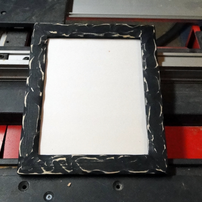

July 29, 201114 yr  I have just finished making 28 picture frames just like the one pictured, but in different sizes. Some of the sizes are nonstandard and made just for one size. I made them out of pine and sculpted the curves, dips and edges on the round end of my belt sander. Flat black was the requested finish. I had purchased the "nail on" saw tooth type hangers. I ran out of the hangers and tried to make a horizontal key hole slot with my table mounted router. I used scrap wood and it did not come out good. First it didn't seem too safe, I suppose it was, maybe it was just me. Second, I couldn't hold the piece in position solidly and it made the slot curvy. Short of removing the router from the table, is there is simple, safe way to make this bit work for me on the router table?

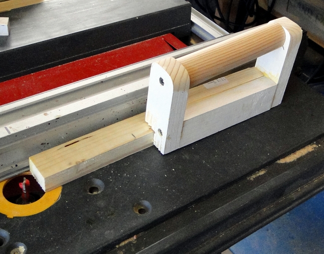

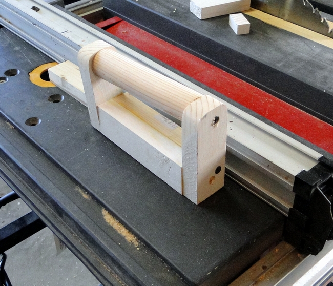

July 30, 201114 yr Author This morning I reread all the suggestions..............thanks all of you. Then I went out in the shop, used some of the things suggested and made me a hold down jig. It allows me to hold the piece securely, plunge and make a neat keyhole. By premarking the piece and the fence, almost all came out very good. The only problem I had was that the bit could not get rid of the waste and plugged up part of the slot. This made it impossible to remove the piece from the router bit. All I had to do was turn the router back on and used the jig to gently reverse it back to my mark. It worked very smoothly and I plan to use it on my next frames, one slot each two sides for mounting horizontally or vertically.
