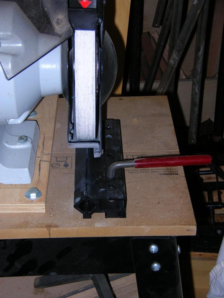

July 30, 201115 yr comment_42670 I have the Wolverine Jig set up on my 8" grinder. The guards are of no issue for the jig itself but for your safety to keep flying metal from hitting you and your hands away from the spinning wheels. I do not have the installation instructions on hand, so here are photos of my set up which hopefully will help you out. The important thing is that the jig bases are in perfect alignment with the center of the wheel and that you have enough space for the locking handles to move freely so as not to bump into the grinder (especially since you have no guards as that could scrape your hand up pretty badly). I had to raise my grinder up a bit higher so as to have the proper clearance but your installation may be different. You want to make sure that you have the jig base mounted so that it is held firmly in place by all the screws/bolts necessary and that the jig accessories can slide in and out of the jig bases fully and be supported and that the locking handles (or your hands)Â will not come into contact with the wheels as you will have to make adjustments while the wheel is spinning (note: you can adjust the locking handles by using an Allen Wrench to loosen the screw that holds the locking cam to the handle). The installation is not rocket science and should be pretty straight forward. Not all grinders are the same in design or in wheel size so you just have to play with it a bit until you are satisfied with the placement and your safety. Â I really have enjoyed my Wolverine jig as it works well. Make sure that you put good quality wheels on your grinder and that they are balanced. Â Â Â Report
