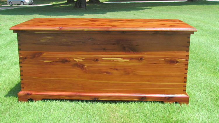

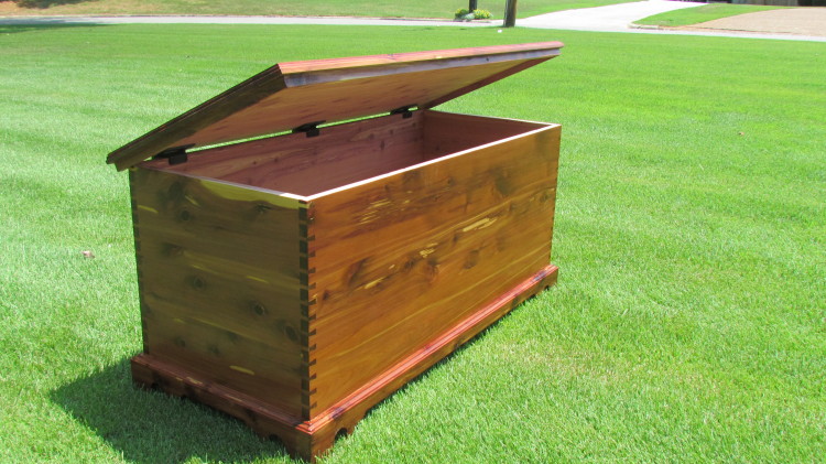

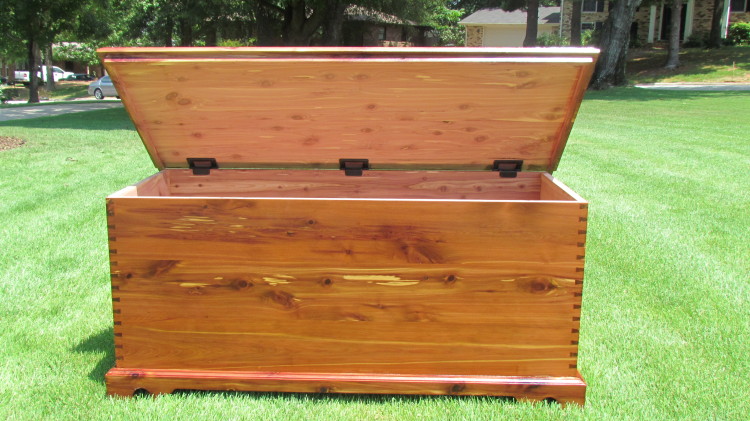

August 1, 201115 yr comment_42534 I finished the Cedar Chest from several weeks back this weekend. It was already close but I got the Shellac sprayed on and I am happy with it. Â Once again I used the Torsion Hinges from Rockler. Love the way they hold the lid in any position and keep it from falling on heads and hands. Â And here is a shot of me with the cedar chest. Â Â Â John MoodyJohn Moody Woodworkshttp://www.johnmoodywoodworks.com Report
August 1, 201115 yr Author comment_42549 Ace, sorry I forgot to put those on there. It is 42" long, 18" deep and 20" high. John MoodyJohn Moody Woodworkshttp://www.johnmoodywoodworks.com Report

August 1, 201115 yr comment_42546 Hey John, beautiful job man. love the warm color of that chest. What did you finish it with? And, the forever curious question, how'd ya do the DT's? John MorrisThe Patriot Woodworker Report

August 1, 201115 yr Author comment_42543 John, I would love to tell you they were cut by hand, but I used a router and a jig. It is way faster than I am and doesn't allow me to make too many mistakes. It is finished with Shellac. I brushed on three coats and them sanded and sprayed on another just to give it a smooth finish. John Morris said:Hey John, beautiful job man. love the warm color of that chest. What did you finish it with? And, the forever curious question, how'd ya do the DT's? John MorrisThe Patriot Woodworker Report

August 1, 201115 yr comment_42541 Beautiful piece, John. Really nice. The dovetailed carcase looks awesome. Adam WelkerRed Car Construction and Fine Woodworking Report

August 2, 201115 yr comment_42539 JohnGreat job. Looks great. Really enjoyed seeing this. Are they hand cut dove tails ? Wayne MahlerGod bless and protect our troops that serve so we can be free. Report
August 2, 201115 yr comment_42538 Very nice John. Shellac is the perfect finish on the outside. Anything else and the sap will bleed through. Hope it doesn't come through anyway. It can be a bugger . Routers do make nice dovetails. I will have to post about a new jig I have. I just need to get it through all the paces yet.bob Bob Kloeswww.bobkloes.com Report
August 4, 201115 yr Author comment_42537 Thanks Lare, I knew I looked really young. Â No Wayne they were done with a Router and Jig. I wish I could hand cut them that good. One day I am going to build one and do them by hand, but it will take a lot of practice. Â Thanks Bob. I really like the Shellac. No finish on the inside. Â Give us a little info on your jig. I am always interested in how others are doing them. Â Â John MoodyJohn Moody Woodworkshttp://www.johnmoodywoodworks.com Report
