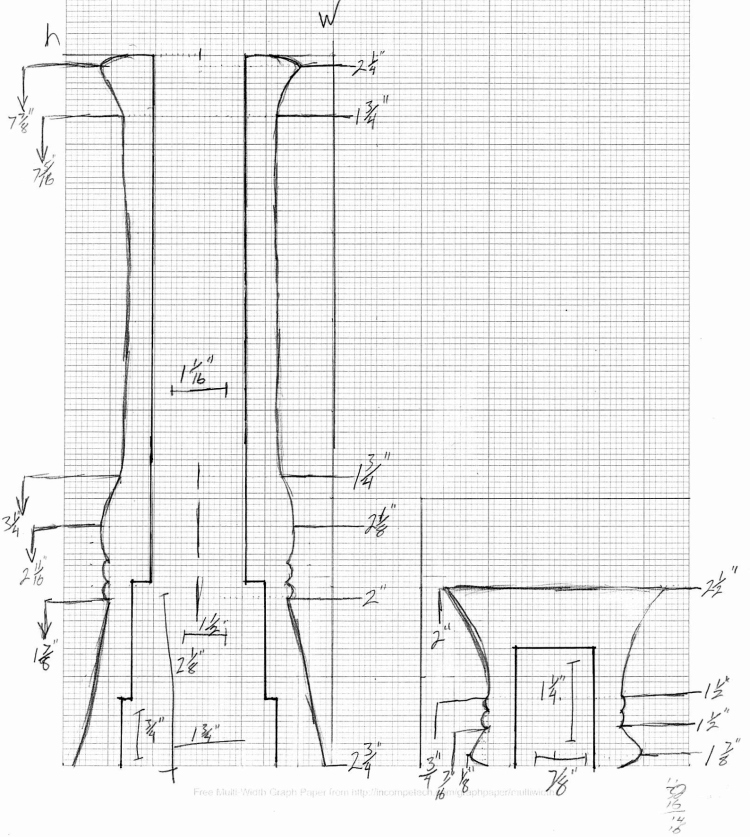

August 1, 201115 yr comment_42490 Alright, I've been itching to taking my turning to the next level, and to start with that I want to turn a Salt/pepper grinder set.  Now as I've only been turning pens up to this point, I'm fairly sure that I'm lacking some essential components like a jam chuck (or any chuck for that matter), a large live center at least 1.25" at the largest diameter, and probably a drill chuck as well. I plan to use the shafted Crush Grind kit as I would like a longer set and like the ceramic head and dial adjustment for the grinder component. So, instead of wandering through the immense number of choices available to me on the various websites, I wanted to get some opinions/recommendations from a set of veteran turners, and where better than here?  P.S here's the design I worked up for the set. Report

August 2, 201115 yr comment_42500 That sounds like a good deal. Didn't realize the kit was specifically for the grinders.BTW, I like your design. Having the "top" separate at a transition point is visually appealing and will conceal any misalignment. Haven't used all of the different grinding mechanisms but some designs work better if there is a "tenon" cut on either the body or the head to improve the stability between the two.Justin Hughes said:I'm the same way, in this case the drill bit kit I was referring to only includes the 4 bits needed for grinder and the and extension. Report

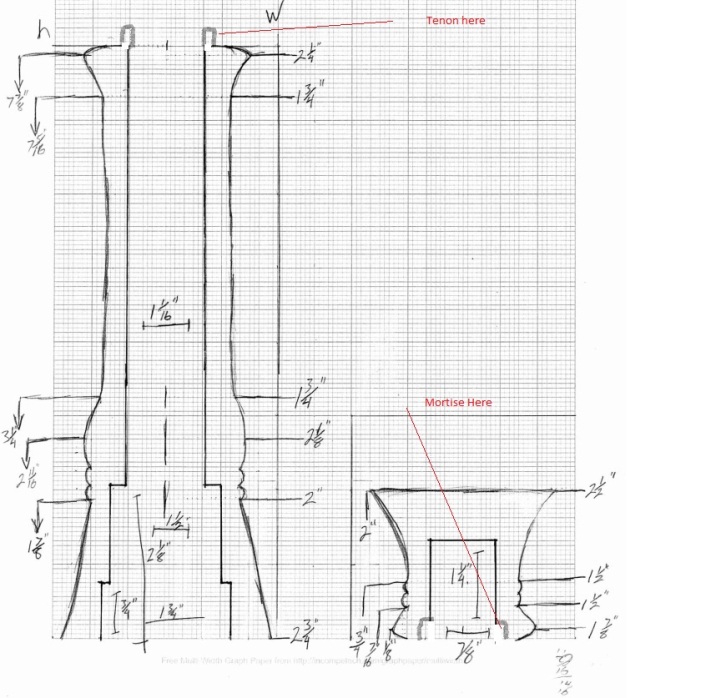

August 2, 201115 yr comment_42499 Hope you don't mind but I slightly modified you diagram to illustrate the tenon/mortise idea- Lewis Kauffman said: That sounds like a good deal. Didn't realize the kit was specifically for the grinders. BTW, I like your design. Having the "top" separate at a transition point is visually appealing and will conceal any misalignment. Haven't used all of the different grinding mechanisms but some designs work better if there is a "tenon" cut on either the body or the head to improve the stability between the two.Justin Hughes said: Report
August 2, 201115 yr comment_42498 I don't mind at all, it is just a drawing after all, and if I wasn't using this particular kit, I would definitely take that into account. I've uploaded the instructions for the crushgrind kit, and you can see on the second page, the top portion of the kit acts as a tenon as well.You can also see it a little better from this http://www.youtube.com/watch?v=FCGcBWSJNpY&feature=related (at 8:00 min he assembles the cap). I will be keeping that idea in mind though as a general rule because now that I look back on all the previous grinders that i've owned, I can see that it has a mortise and tenon for proper centering. Report
August 2, 201115 yr comment_42497 Cool- I'll have to try one of these mechanisms, Thanks for the idea!Justin Hughes said:I don't mind at all, it is just a drawing after all, and if I wasn't using this particular kit, I would definitely take that into account. I've uploaded the instructions for the crushgrind kit, and you can see on the second page, the top portion of the kit acts as a tenon as well.You can also see it a little better from this http://www.youtube.com/watch?v=FCGcBWSJNpY&feature=related (at 8:00 min he assembles the cap). I will be keeping that idea in mind though as a general rule because now that I look back on all the previous grinders that i've owned, I can see that it has a mortise and tenon for proper centering. Report
