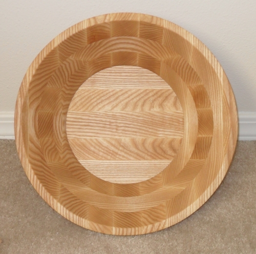

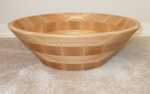

August 11, 201115 yr comment_42044 I found bowling making very addictive. There for awhile, I did nothing but bowls. They are fun and truly challenging. Here is one I consider my signature design. Â This one is 13 inches in diameter and made from ash. SQ Report
August 12, 201115 yr comment_42043 Great work Susie. Any thoughts or advice for folks wanting to take this task on? Wayne MahlerGod bless and protect our troops that serve so we can be free. Report
August 12, 201115 yr comment_42042 Beautiful Susie. looks like you'll be our resident scroll saw bowl expert  Greghttp://www.thesawdustfactory.net/ Report
August 12, 201115 yr comment_42041 Thanks everyone for the kind words.  Geez, seems I should have proofed that post before I posted it.  As everyone probably figured out it should have read: "bowl making"   As Greg said, for anyone interested in making bowls -  Carole Rothman's book called " Wooden Bowls from the Scroll Saw" is a must have.  Carole goes into great detail on how to make bowls and even includes a cutting angle chart which is essential for creating rings that align perfectly.  She also has a pattern and instructions for making a bowl press.  The bowl press makes gluing up the rings much easier and gap free.  I have made several presses in different sizes and even one that accommodates different sized bowls. But I'm warning you - they are very addictive.  I spent a couple of years making nothing but bowls.  lol  I took her general techniques, made my own patterns and super -sized them.  The bowls in the book are small, but they are a great way to learn the basic concepts of bowl construction. I'm no expert on bowls, but would be happy to try and answer any questions. SQ   It it can't be fixed with glue and sawdust - it's not worth fixing. Report

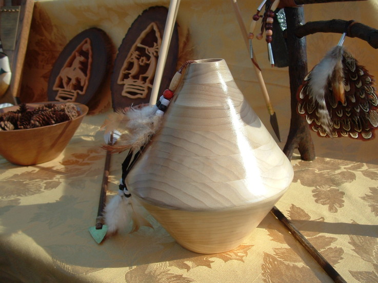

August 20, 201115 yr Author comment_42036 Awesome bowls Susie! Great links Mike! I saw these bowls at our local woodworking arts and crafts fair and I was blown away at how beautiful they were, and as I talked to the maker of the ones pictured above, I loved the idea that his were made entirely from shop cutoffs, being the reclaimed wood junkie I am, I was happy to see scraps being used once again in an efficient manner instead of heading for the mulch pile. John MorrisThe Patriot Woodworker Report
