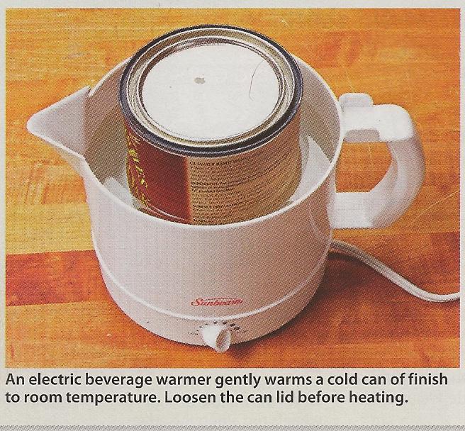

August 19, 201115 yr comment_41717 Good morning Friends,If you are in a cold climate and your shop is in the garage how can you warm up a stain or finish in order to use it when needed? Report
August 19, 201115 yr comment_41720 I move them to the house in the winter months. to keep the warm a baby bottle warmer, coffee cup warmer hot plate with a water bath in a pie pan, aall will do the job Report
August 19, 201115 yr comment_41719 I "appropriated" one of my wife's old electric candle warmers. The kind where you inserted the entire "Yankee" candle- glass container and all- into the warmer. It melted the wax candle without a flame. Works great for warming finish. Just set the opened can inside the warmer. It will hold up to quart sized cans. Report
August 20, 201115 yr Author comment_41718 Good Morning Fellows, You both have the answer for the job and here is another method with the same results. Report
