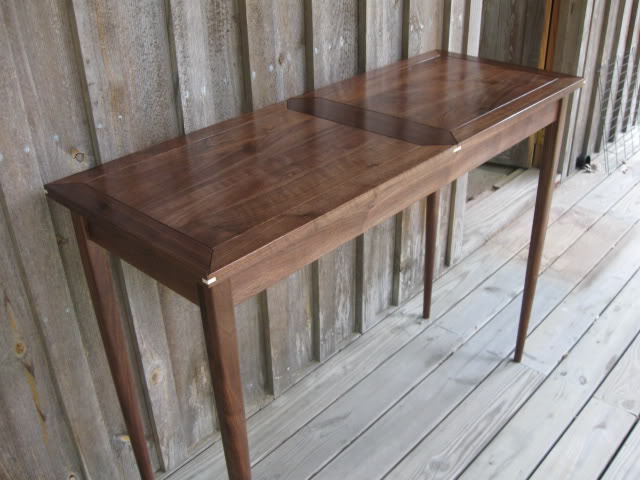

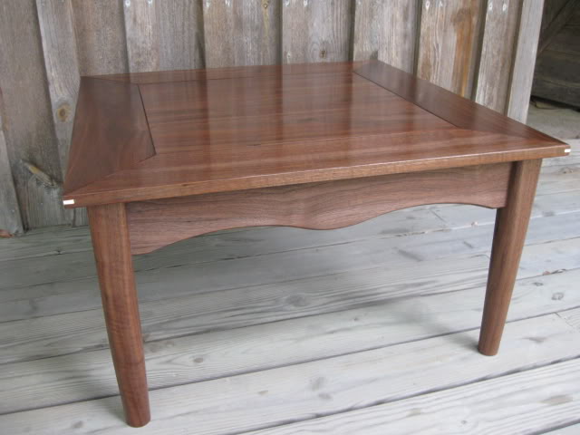

The great thing about this jig it can also be used to make perfectly tapered table legs too!!
