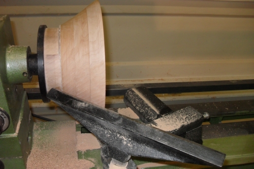

Any special concerns I need to be aware of when using the outboard?
My larger bowls can only be done on the outboard due to the limited size of the inboard (14")
I'm wondering if there are any unusual concerns - especially safety issues that I need to be aware of when using the outboard.
All suggestions, thoughts, tips, and comments would be greatly appreciated.

Safety concerns will pretty well be the same as if you are turning in the normal mode.
Make sure it have it securely attached to a face plate of what ever you have holding it.
If the blank is out of round, take it slow until you get in balanced.
Tools of course need to be sharp.

I solved the problem with the tool rest!  On a whim, decided to see if the tool rest from the old lathe would fit the new lathe.  Low and behold it did.  I am now able to finish the bowl I have started, and other bowls that don't exceed 13 1/2 - maybe even 13 3/4 inches in diameter.  :)  The solution to the tool rest dilemma has been right here in the shop the entire time - and I just didn't know it. ning-newtoolrest-41566-85.jpg

Keep a close watch on your tool rest.  The more you extend it, the more torque you put on it.  Think using a lever.  The longer the lever, the more force you can apply.  When you are turning you are transferring the force from the tool to the tool rest and then into the lathe bed and on to the floor.
Keep all the locking levers tight, keep the tools sharp, take light cuts, and wear your PPE.

Here is something I'll bet your husband could fabricate. A floor stand will reduce the forces on the "extension" tool rest.
http://www.toolpartsdirect.com/cgi-bin/schematic.cgi/delta/46-697/
I was turning a bowl and the gouge caught- snapped my tool rest off the post. Got it re-welded but it has never bee the same. There are tremendous pressures on the end of a long tool rest. So keeping the forces as close to the mounting post as possible will reduce the likelihood of failures.

Thanks for the information about the portable tool rest.  Might be a good option if this outboard isn't sturdy enough. Seems Grizzly has changed the configuration on the outboard tool rest on the new machines they are selling. Appears to be stronger and more stable.  Plan to order the parts I'm going to need from Grizzly.  If this new configuration doesn't work, will seriously think about a portable tool rest.

Sounds like very sound advice.  I'm thinking I am going to concentrate on the inboard turning before I try anything else.
I agree, safety first.

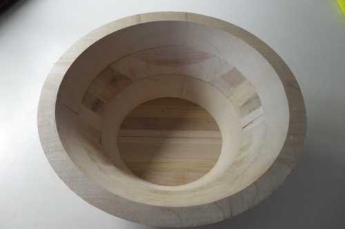

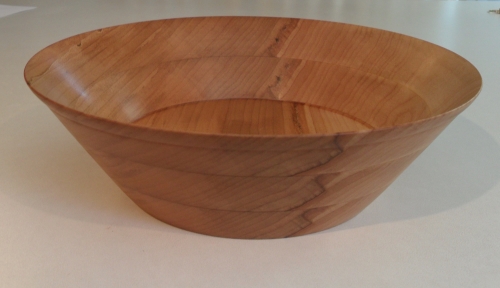

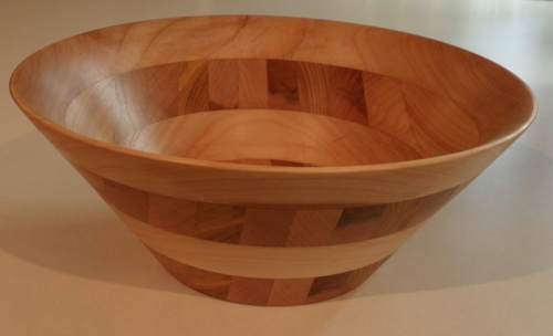

Nextbowltoturn..jpgHere is a recent one I turned.  I cut out two bowls on the scroll saw.  One made from plain maple.  The other bowl made from edge grain laminated pieces of maple.  Each bowl was cut using the same rings sizes, and cutting angle.  I mixed and matched the rings, and here is one of the bowls before it was turned and after it was turned.

Greetings SQ
Very nice pieces....
