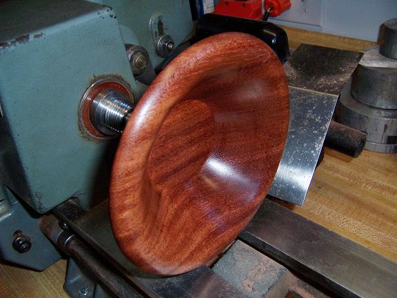

And the bowl. Dunno what happened.

Very nice bowl Larry. Love the look of that Walnut. Is this a recent turned bowl? Man it looks great. Very smooth, what did you finish it with?

Very nice looking bowl. Nice Job guy.

Thanks, guys..  John2, it's not Walnut.  I'll look it up and re-post.

BUBINGA!
I uses a thinned poly and applied a couple coats with a cloth at slow speeds.  After drying, TreWax and 0000 steel wool while still on the lathe turning.

I should have noticed that, It just looked dark like Walnut in the picture.
So what did you finish it with?

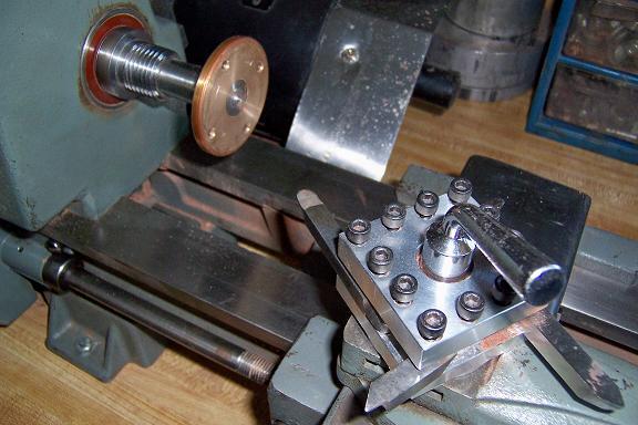

A stainless steel clamping lever that locks down the square turret to the cross-slide.

The bowl looks fantastic!  I love the way you created the edge of the bowl.  What wood did you use?

Thanks, Sue..  It's Bubinga.

Gosh, I was not familiar with this wood, until I just googled it.  Food safe, often used for musical instruments.  This wood can even be found in Lexus vehicles.  Beautiful exotic wood.

The 6" diameter x 4" thick  Bubinga bowl blank was $20.  Turns well, at least on a metal lathe using two hands..

My problem is I like big bowls - 12" to 15" in diameter.  I think I would have to mortgage my house to afford a piece large enough to accommodate a 13 3/4 inch bowl.  :)  I'm going to have to win the lottery before I can play with the exotic woods.  I read that wood is hard!

It's also a little btittle because of it's hardness and changing grain directions.  Finishes well.  See my earlier post in this thread on how I did that.
And John2 had a good observation.  It does look like walnut when it's finished.
